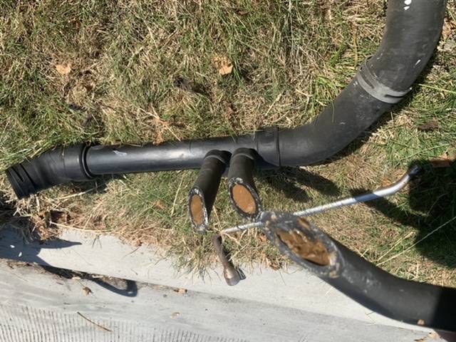

Hey, not sure if you’ll see this, but I finally got all the parts together and started this project. I discovered clay like gunk in the radiator tubes while disassembling. (Step 10c or so).
Does this indicate blown head gasket? That’s what doctor google is telling me.
Is there a chance that anyone ever put any kind of stop leak in there? Warped heads (more so than actual head gasket failure) is a possibility, but it is very rare on this engine, in part due to the fail safe cooling.

I guess you could try lots of flushes with tap water and maybe some of the radiator flush chemicals. In addition to replacing all the usual plastic parts, I'm sure you'll need a new DCCV, aux pump, and radiator. I'd replace the water pump too. I strongly recommend Motorcraft for most of the above, but the aftermarket radiators seem to be okay. The aftermarket DCCVs and thermostats are terrible.

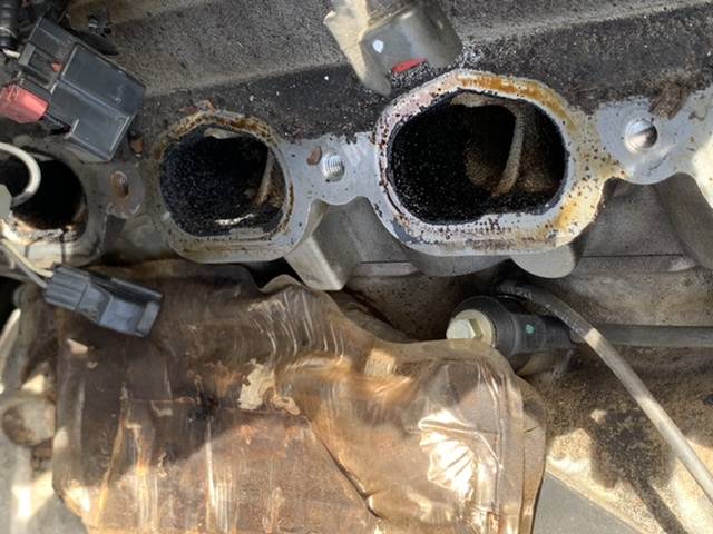

Ok, well, after far too much hemming and hawing and delays, I’m in to the manifold, and the news is... I don’t know. There’s no fluid in here, but there’s plenty of charring. Am I fine to just scrape this stuff off and call it good?
And that insulation bag seems cooked, is there a way to get another two to replace it?

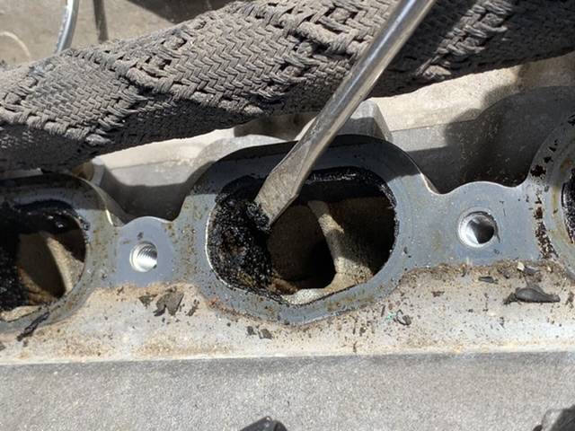

I’ve attached a photo of the charring from above, I’m going to work on cleaning the other half for now. Is there some good way to clean that out without letting it all fall in?
I will replace the other stuff you mentioned, and I’m only using motorcraft for anything.
That insulation bag looks fine.
I'm not sure what to make of the line about the manifold. No coolant runs through the V8 intake manifold.
It's normal to have some crude in the intake passages. It's mainly from the PCV pulling oil vapors in, and maybe a tiny bit from the EGR. It's probably too late now, but you really don't want to disturb it in any way that lets any hard particles fall into a cylinder, where they might scratch the cylinder wall and cause an oil consumption problem. The trick is to turn the crankshaft till the intake valves on that cylinder are fully closed. Then clean what you can and vacuum all the crumbs out before turning the crankshaft to close the next set of valves to work on the next cylinder.

gotcha! I have only cleaned the ones in the upper manifold, and I’ll do as you say with the crankshaft and vacuum to clean the lower ones. Thanks, I knew there was a right way to do that.
I was confused about the coolant flow, for some reason I thought it was up in there too. Once I have this cleaned up I’ll move on to the pump, dccv, radiator, and all that. Thanks for your help and support.
