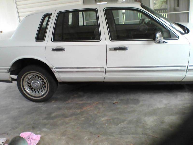

      top gun it sounds like a electrical problem you should check the fuse first that was my problem then check the compressor it should stop when you open the door you may have a bad sensor that tells if the door is open or a short somewhere in the circuit my 1993 Lincoln was stuck up like this for a month bad air suspension.jpg
