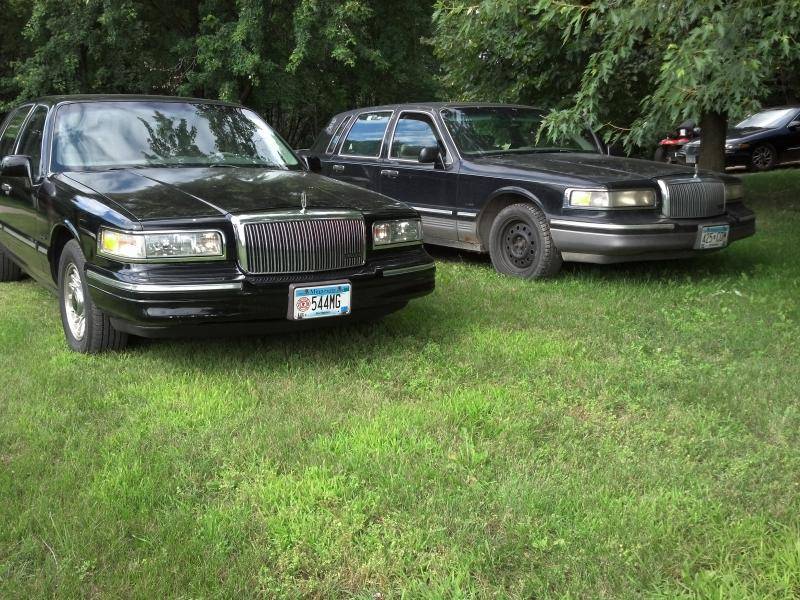

Needs blend door actuator and cruise control fixed.
Has anyone put memory seat function into one without it on here before?
Do you have a LF seat motor assembly available with the memory feature to swap into the car? There are position sensors that are a part of it and also the power recliner motor if so equipped. You will also need a left front seat module and, a memory seat switch and of course the wiring harnesses to make it as easy as possible, although it can be free-lance wired if you know your way around a road map.
It sure wouldn't be worth all that effort to me, but that's me.
I have all the needed parts in the 95 next to it
Just wondering if its a simple 1 day job.

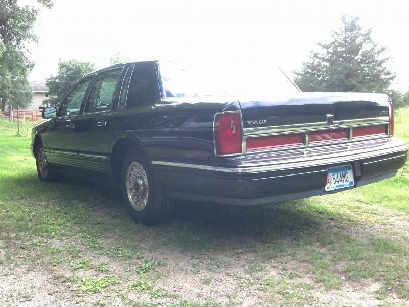

Did plugs, trans flush and air filter.
She's running much better so I washed her and scrubbed the wheels to reward her.
Blend door actuator fix it self so now it will fail in January.
