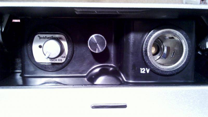

I'm going to redo the ash tray assembly to house dual power sources and a usb port. Either that or its going in the center console for a usb stick of music......no need for an MP3 player.

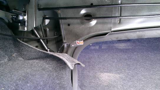

I did see a thread you mentioned the doors are considered 2 each? I added a factory rear sub box from another LS and actually am not sure if it had it to begin with. I had to mount it and just hook it up to this connector and it worked right off the bat.
I'm glad to hear everything plugged right in :Beer
...or you could redo the ashtray to accommodate something else...like idk, maybe a bass knob and a LED control knob ;)
