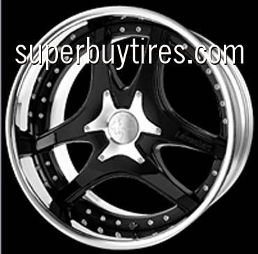

opinion on these
First of all these wheels belong on a Toyota celica in the hood NOT an LS. Secondly, with a +38 offset you sure to have several thousand $$$ in suspension work over the coming years. And thirdly, the comfortable yet tight ride of the LS will suffer.
The price is good, but I think that 7.5 in narrow for the LS, it would be better to go with some 18x8 rims, if you really want to go with 18s though..

why would the +38 offset kill the suspension (n00b question yes i know...) but explain away
Offset is the distance off of the centerline where the mating surface of the wheel meets the hub. The LS has a rather large offset (60mm), as do a large percentage of FoMoCo cars of the last 15-20 years. When you go from 60mm to 38mm, you're moving the mounting point almost an inch farther in towards the center of the wheel.
One inch doesn't sound like a whole lot, but when you consider that the stock wheel is 7.5" wide, that's significant percentage.
Moving the offset changes the forces on the suspension. Basically, the wheel acts like a lever on the suspension components, and using a wheel with a different offset changes the fulcrum point of that lever. That, in turn, can drastically change the forces on the suspension components, in some cases multiplying the resultant forces.
That leads to premature component failure, quite possibly at a very inopportune (read "dangerous") moment. Actually, I'd say it would probably fail at a dangerous moment, because the forces will be greatest when doing something stressful, like cornering...
