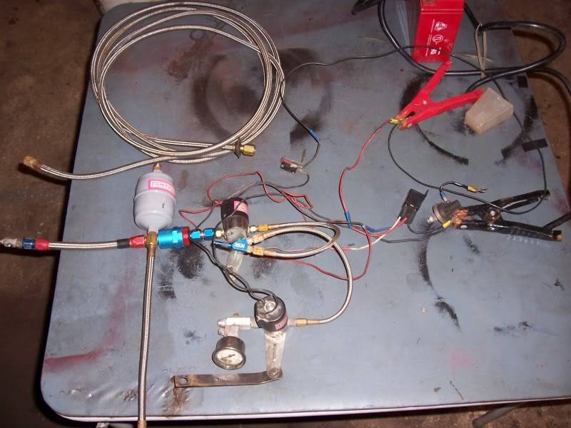

Pulled this off my conv street stang. Its been on the car for 10 years now. Its half of a 500HP double spray bar kit that was on my green stang. All parts are Compucar kit with a single NOS fogger nozzle wet kit. I'm testing out the soleniods here to make sure they open and close ok before mounting them.
Will be filling in more with the install as it goes. Don't think I will do this as a hidden kit.

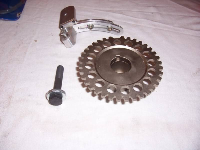

One step closer. This UPR unit looks nice being all billet and stuff.

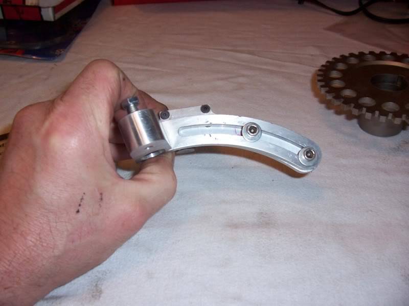

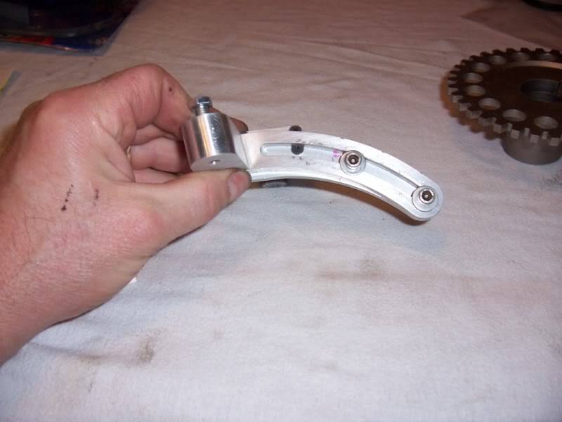

Its made with a stock "F2" (1992) encoder wheel. The only thing about this slider style compared to the degreable encoder ring style, everytime you make timing change you have to check and set pickup clearance. I will mod the unit so I don't have to do that. Here are 2 pics showing large movement of slider.
I hate UPR anything. Never had luck with their crap.
I have never liked the look of there mustang susp stuff. This was CHEAP and it will do the job I need it to do.
Your timing is already advanced through your chip. I would not mess with that upr timing adjuster... Do it right by having a chip with 2 different tunes on it.
Thats why I bought this to lower timing, A dual chip is not in the budget.$450 for dual chip right? I still can't find any total timing specs for these stock and what the chip "guys" bump it up to. I have noted the timing specs as car sits now. It will do the job I want it to. Cheaply.:) I'm going to start post about timing.
