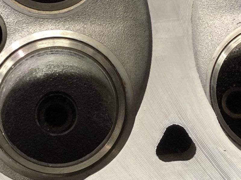

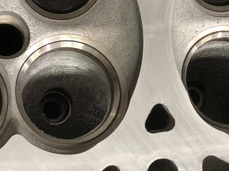

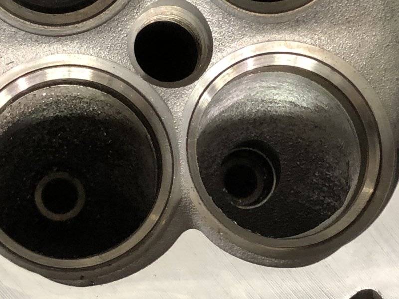

Getting the heads done, magna flux , new guides as needed, valves ground, hears planes off. This alone will help any car and more with a boreing and new rings . I am now all for you . Valve job and heads refirbished would do it more goodO(hp)
I'm actually going with the factory 3cc dish style pistons, mod max sells the ones I am buying, they are a 3cc dish speed pro and with those pistons on any stock 4v and un-milled heads it shows a compression rating of 10.2:1, however as you guys said I will be getting the heads milled as well. 10.5:1 sounds like a pretty accurate estimate for compression Chris. I want to get the cams degreed as I know this makes a big difference but I won't be getting the adjustable cam gears to really do it right so I will just be having them installed un-degreed. This is fine with me though, I've seen 03-04 Mach 1s w/ C heads pick up 20 rwhp from 96-98 cobra intake cams UN-Degreed. So I am hopeful. My engine builder showed me multiple other 2v and 4v motors that had the same piston slap issues mine has, seems to be a very common issue that I would most definitely look in to if any of you other guys plan on rebuilding your engines too.

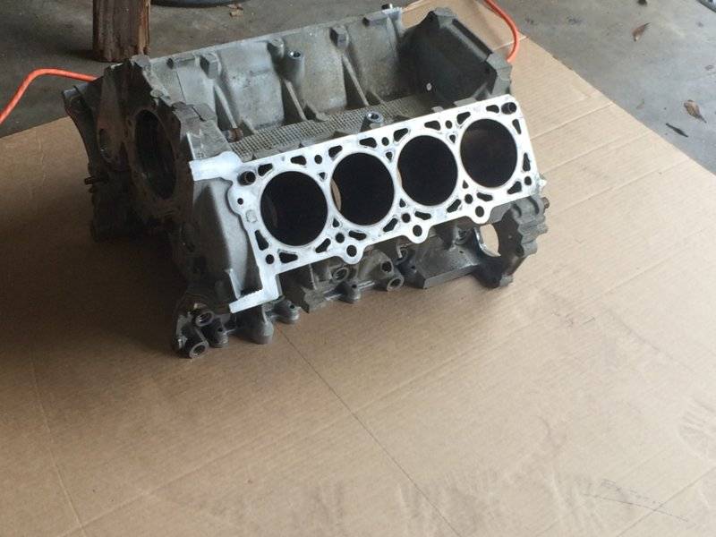

My block as of 45 minutes ago right before I picked it up and loaded it in the truck to drop it off. These blocks are stupid light, so glad the Teksid is aluminum. I can pick it up myself effortlessly

Those heads look tops and from my past experience a valve job like this alone would make the car run like a new mark. or stang
