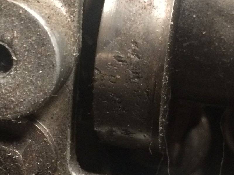

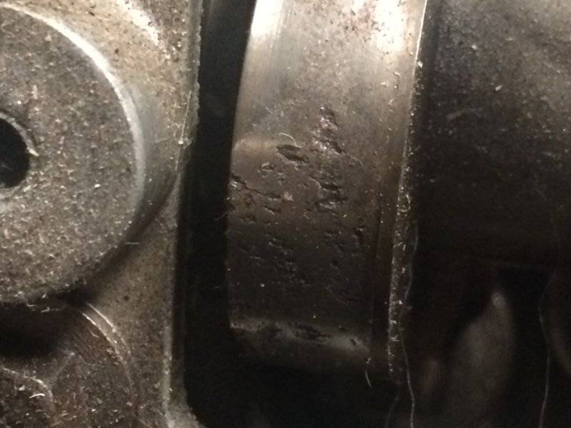

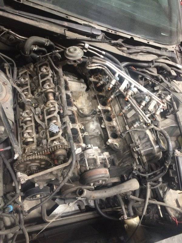

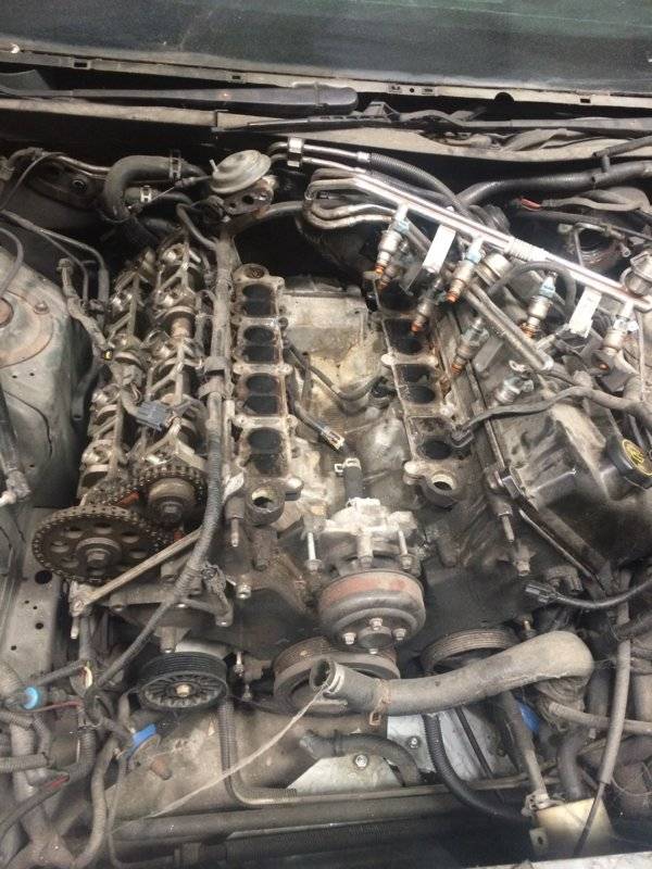

The situation: Some time ago my car started making excessive valve train noise from passenger side of engine. I pulled passenger valve cover and discovered both the Intake and Exhaust Camshafts have damage to the lobes. Cylinder head has very small amount of metal shaving sitting on head surface by camshafts on passenger side, upon further investigation I also discovered my primary chain is very loose where it is tensioned on passenger side, chain is still tight with no slop or "play" on driver side. Don't want to beat a dead horse but what is my best route to get the M8 back on the road?

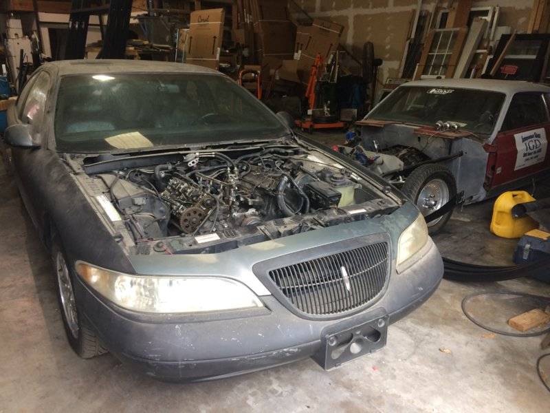

Really want your guys input on this. Car is sitting with no intake manifold or passenger side valve cover on engine inside my shop out of the weather. I need to come up with a solution soon.

Passenger side Intake cam lobe damage. (Note: That is dust in pic from not having valve cover on engine, not metal shavings. Just to clarify)
I haven't been into one of these 4 cam engines but I have lost a cam lobe or two over the years and that metal will go through the oil pump and I have seen it get to the crank and inserts/bearings
You should always at least check the bottom end, best case it does little damage to the oil pump and gets caught in the oil filter, worse case it gets to the crank and rod bearings/inserts

if there is a substantial amount of metal in the motor, you're just going to want to get another motor.

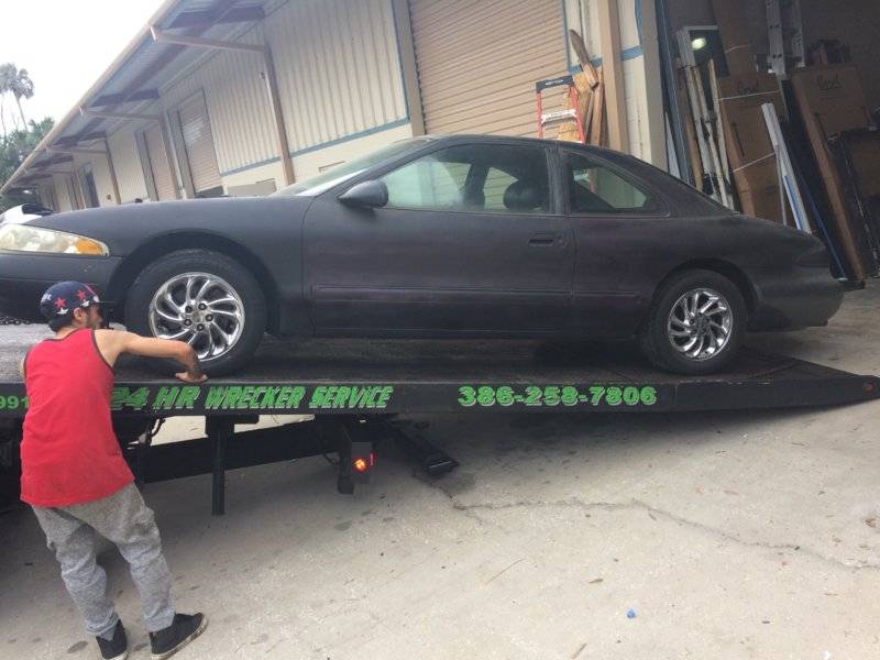

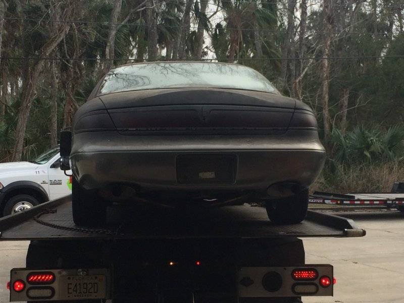

Car is getting picked up by Danny's towing in Daytona Beach,FL in just a few minutes and getting brought to US-1 auto to have the engine removed. Ormondgt98 is rebuilding the engine and installing the Kooks headers
I am paying 800.00$ to have engine removed and re-installed by US1 auto. 675$ + parts to have the engine rebuilt by OrmondGt98 and 65$ to have Danny's Towing pick up the car. If all goes well car will be running like a champ again in 3-4 weeks
