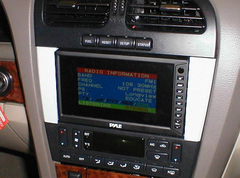

Instead of cutting from a donor radio, I bought a $12 dash install kit for a single din radio for the LS, and am modifying it. All I am using is putty (bondo) and sandpaper. It is starting to look really good.
My only problem with using the stock metal bracket is that it forces the new hu to stick straight out, instead of allowing me to angle it upwards a bit to match the angle of the stock radio.
All in all, its starting to look pretty good, and I'll post pics when its totally finished. I am installing a carputer, and I'm making in-dash control buttons on my trim plate. It should look pretty cool.

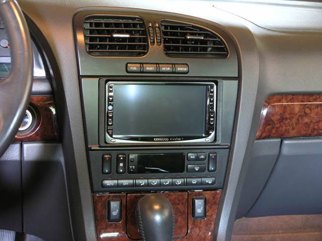

A good friend of mine (ex-installer) did the face plate for my kenwood. The face plate from my original factory HU was removed and cut out to fit with tight tolerances around the trim ring you see in the pics. The trim ring was taken from a Ford Escape install kit because the top and bottom of the ring is thinner than the sides. The top portion of the factory face plate that you will have to cut out (you only get one try) is very thin when you get done so be careful and take your time.

I like it for what it is. I am going to run a carputer setup that will do all my music, radio, and navigation, and I needed an lcd screen with a built in amplifier to control the speakers.
If you want to use the radio thats built in, its pretty ugly. It has a surprisingly bland radio screen.
I know that it has a bunch of rca inputs, im not sure if it has rgb, but I'll check next time I pull it out. I'll also get some pics up in the near future, after the holidays.
About the trim rings- seriously, instead of cutting up an expensive stock radio, cut up a $12 radio install kit. I've already done this, and it is starting to look great. They come already formed to the dash, you just need to cut certain parts and fill some small gaps with bondo or epoxy. If you can use epoxy, sandpaper, and paint, you can save a whole lot of hassle. Its great for people who don't have precision tools, like me!
Update: Here is a pic of my install progress. I've primered the trim sections. I still need to make a lower trim section from the trim kit, and there isn't enough room for the upper one.
I don't think I can angle my unit up at all, because it seems to be too long to work (it bumps into the metal bar behind the radio).
That is EXACTLY what I was looking for. You used a trim ring from a Ford Escape kit. Outstanding!!
I think what I'm going to have to do is get the single din LS install kit and the Escape or whatever kit to use the trim ring. I was cutting near the top of the stock faceplate yesterday and the cutting wheel heated up a little too much on me and I got some meltage which ruined it.
About the restraint on the HU, did you just adapt the factory brackets?? What about attaching the faceplate??
