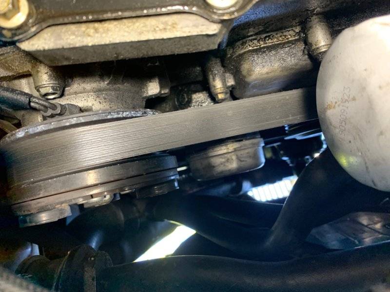

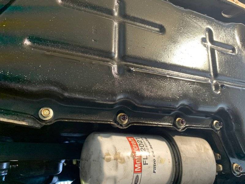

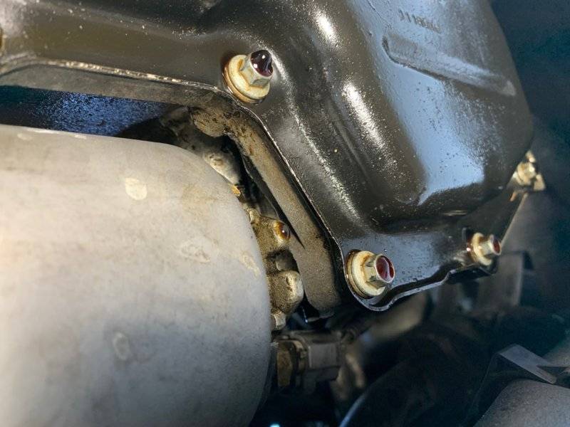

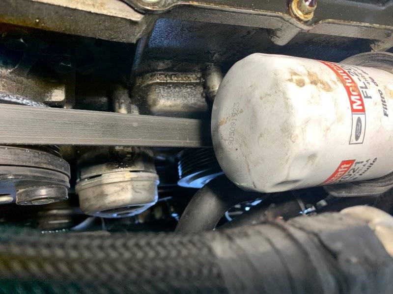

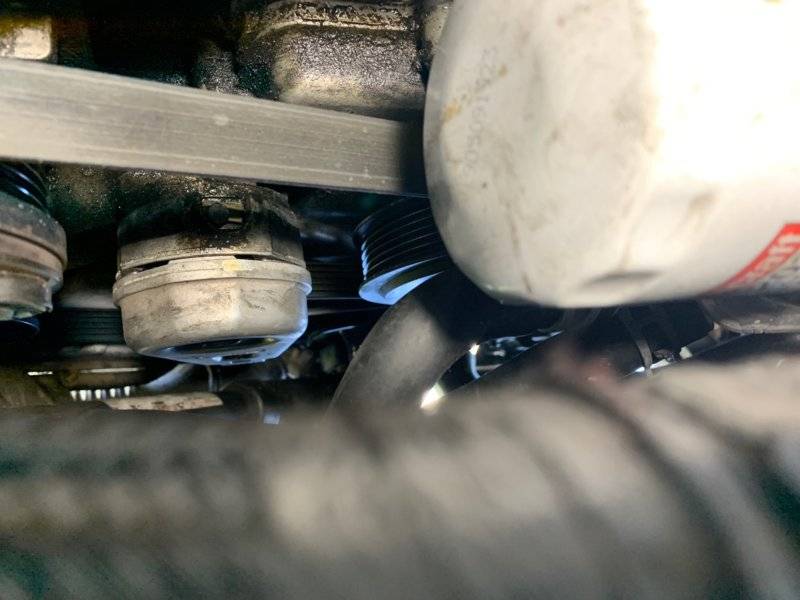

So rather than start a whole new thread, here are some pictures from underneath my 2004 V8. I have replaced the oil cooler, oil filter adapter gasket, oil pan gasket and the leak is still, well, leaking. The car is running tremendously. Just did a 300 mile jaunt down to Camp Pendleton from north of LA and got 24 mpg (with sitting in traffic for a portion of the trip). Temp was below 200 for most of the trip, when I wasn't sitting in traffic.
I do smell oil when I exit the car after turning the engine off. I'm afraid replacing the engine cover gaskets may be in my future, ugh!!!

I have the same issue with both of mine. I have changed all of that as well as valve cover gaskets and the front shaft seal. It wasn't one of those either. By this process of elimination, I feel like it must be the front timing cover gasket. Now, that could be a $1500 job or a few full days of my time. It's not worth that to me. $150 is probably closer to right for the V8 oil pan gasket.
