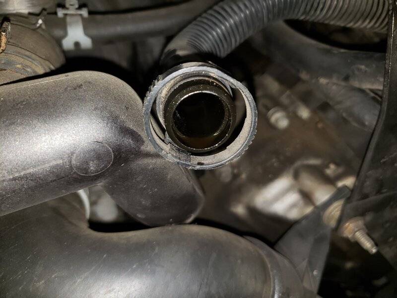

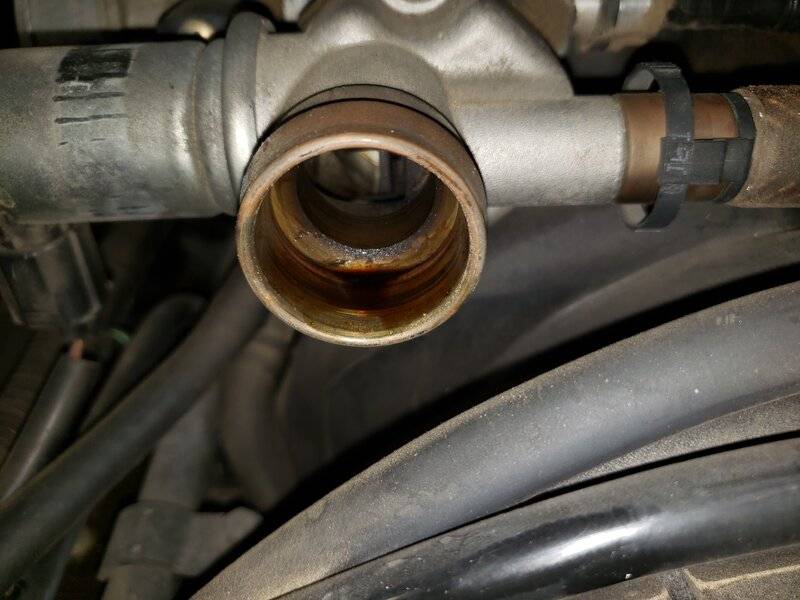

2002 V8. Been noticing the accelerator sticking at the beginning of travel lately. Took off the intake hose to find this:
Is this normal? Is there a recommended way to clean other than throttle body cleaner and rag?

It is normal to see some oil in the plastic tubes of the PCV system (those aren't vacuum lines). Plus it is normal to see oil puddled in the intake manifold when you look past the throttle body.
Does the car idle smoothly or rough? If rough... that points to a potential vacuum leak... which can create a siphon effect on the oil... or something mechanical. If the cam timing jumped a tooth... that will affect engine vacuum.

Most fuel injected cars always have an oily residue build-up from the throttle body to the heads. You just need to clean that with some throttle body cleaner. Luckily we are not direct injection, those engines need regular walnut shell blasting to clear the buildup all the way to the valves!

An oil catch can is used to "catch" oil in the PCV system. If you were to pull the throttle body off ... you would see oil puddled in the bottom of the intake manifold.
When a catch can is put inline in the pcv system... (like inline with the long 3/8" i.d. hose that goes in near the rear of the intake manifold) as the oil passes through the catch can... it falls into the can... preventing from going into the manifold.
While it is helps... I don't think this is your issue though.

I wouldn't expect that. Take the oil fill cap off with the engine idling. Put your hand or a paper towel over the opening. Is it sucking in ever so slightly, or is it puffing out? Sucking in is normal and correct. Puffing out indicates worn out piston rings. Some oil in the intake, for better or worse, is normal.
Thanks Joe, that's helpful. I'll check it out. Maybe I'm lucky and everything's fine, it's just been too long since I cleaned things out.
