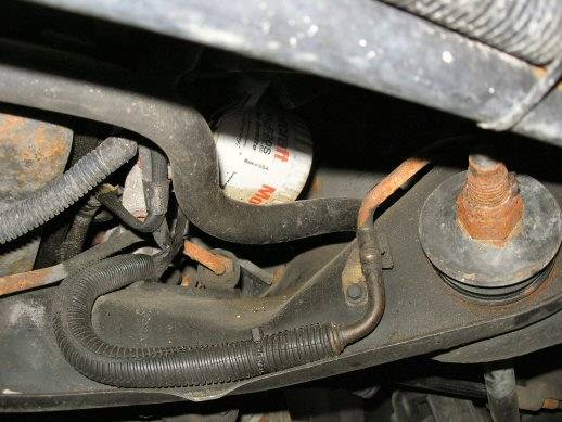

how do i get my oil filter out???? and yes i did a search
You um.. You unscrew the oil filter from the motor...?
That's a good start.
:lol:
The hell do you mean, how do you get your oil filter out? Do you mean, how do you take it out of the super tight space after you unscrew it?

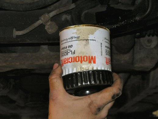

You have to rotate the filter, and pull it out lenghtwise. It will magically come out of there when turned just right.
A an oil filter relocation kit is a hot seller for these cars, now you know why :)
I just got done. thats one of the hardest things i think ive ever done ( how did i know frogman was gonna come back with a comment ??)
Thought about it... ah heck, here ya go:
Front and center, dont even have to life the car up to change the oil now :)
yeah i finally got it out. It took me awhile and with alot of force it finally came out.
Once you do it a couple of times it's actually pretty easy. A relocation kit is not a bad idea at all though. Should have had it from the factory!
