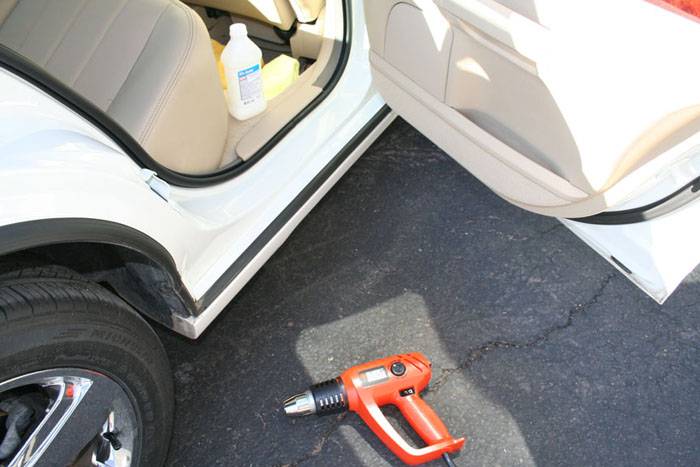

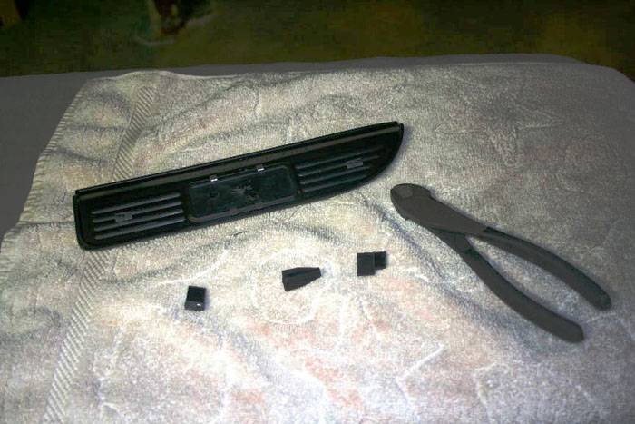

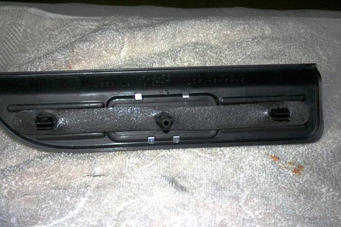

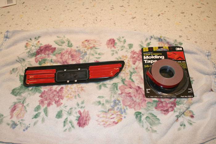

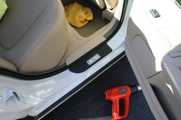

I added them to my 2006, and the installation is easy. The parts come with tabs that are designed to be inserted into holes in the body. I cut those off with cutters, sanded down the nubs, and mounted the plates using double sided molding tape. I can post a full How-To if people are interested.

Todd; thanks for posting a picture of the install.Now I know what the finished product looks like,considering we have the same color combination!

I would not drill the holes in the sills for a "factory" install. Just cut off the mounting posts on the bottom and us 3M double sided body mounting tape to hold them in place.
That's what I did and trust me.... They will not come off. EVER!

Tony's right, its not worth drilling. Using the 3m Mounting Tape is the easiest and safest way. See photoz:
