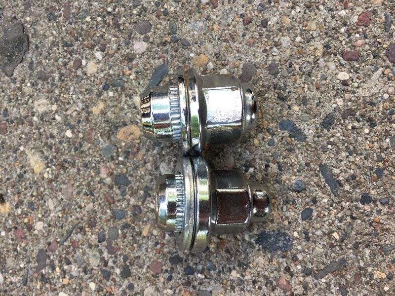

I have a 2005 V8 Ls and I’m looking to replace the lugnuts. I currently have aftermarket Toyota lugs and I believe that they’re what’s causing my wheels to shake. When I put new tires on yesterday I noticed the shank looked longer than the hole in the wheel so even though they torque down properly I don’t believe they’re holding the wheel fully flat against the hub. Anyways I looked at Ford parts giant and the OE lugs were $7 a piece and dormans were only a couple bucks a piece so I was wondering if anyone had used the dormans and if they work well? If it helps I have the 7 double spoke wheels and the lugs are mag lugs.

So the Toyota lugs were definitely too long. I put in the dormants and the shake reduced dramatically but is still there. Anyone have any ideas? Tires are brand new Bridgestone Turanzas, wheels aren’t bent, they’re balanced properly, and the hubs are clean. The shake comes on lightly at 25-30 and gets worse with speed. The mechanics at my shop said the steering wheel shake would only be from wheels/tires or an axle but the car is rear wheel so I’m at a loss.
Well balanced tires will still shake if they aren't perfectly round. You could have them road force balanced. That should pick up any roundness problems. My 04 had the shaking/rocking steering wheel issue. Tried a few things, but a set of four new (different model) tires cured it.
Your nearly new tires may have been damaged by the loose lugs. Maybe they are cupped now?

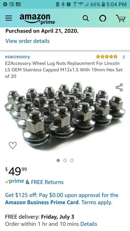

I put Dorman lug nuts on my car a long time ago, and every single one of them are rusted totally. I have to spray garage door lube oil into my socket whenever I move tires, or the socket will stick to the rusty lug nut and be a pain the ass to remove. The Chrysler Sebring lugs were stainless and not capped, but I let them go with my first LS that got totaled. I thought I was getting a set of those when I ordered the Dorman, but I did not.
Good to know...
Just the outside is rusted up, the threaded part and the lug snout are all good. I should have stated that first. Plus being in NH is not helpful. They would probably work great in the deep south.
Possibly so. All of my original lug nuts are still good.

I used Dorman 611-117 nuts for the sebring/galant the first time. They're chrome plated and rusted/flaked very quickly for me, definitely not stainless. But they still worked perfectly fine as a nut.

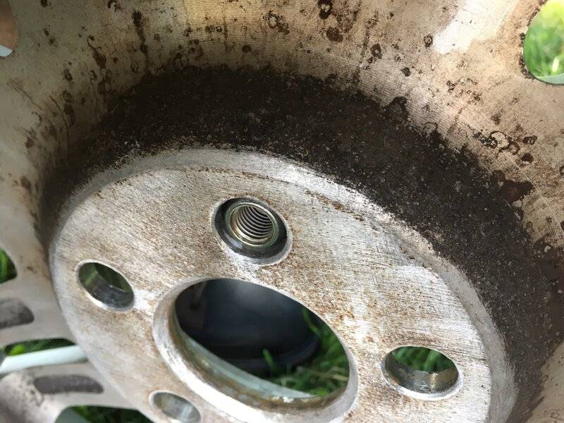

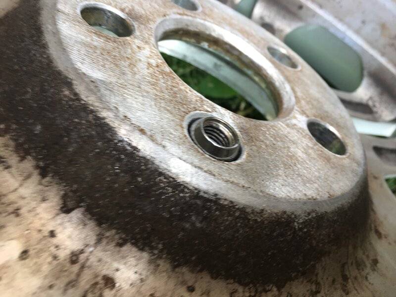

I now have Toyota-specific Gorilla splines, but yes they're a deeper shank. Turns out the seat in Jaguar Zeus wheels are a little thicker than the 5-spoke Sport wheels I took off. If you take off the wheel, snug up 2-3 nuts against the rotor, and count how many turns it takes to put on another lug nut, you can then compare how many turns the nut makes with the wheel mounted. My Zeus wheels had 1-2 turns to spare, my stocks were short 1-2.
Sebring nuts on stock wheels had 1-2 to spare.
Ideally, you want 12 turns on these cars for 18mm thread engagement, though that's a racing requirement. I'd never go less than stud diameter, 12mm, which is 8 turns (8 turns*1.5mm/turn pitch=12mm)
Meanwhile, Sebring nuts through stock wheels hit the rotors on my Fusion. I wanted to use the old LS wheels as winters for the Daily, but those rotors did not have the countersink around the lugs. Something was weird about it when spinning it to check for clearance after snugging them up. Sure enough, a good tug on the wheel made it tilt and wobble
