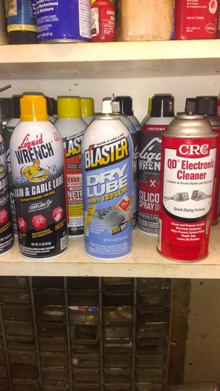

Well I wasn't surprised at the first answer...I figured I would have to remove the cluster ...thanks for the information...I'm very pleased that I can try applying some PB blaster to the steering column...much appreciated Joe!
I certainly would not use PB blaster. That'll wash all the grease that is left off and may damage the steering angle and other sensors.
You need a relatively thick lubricant.
10-4 Joegr! upon removing the lower steering column shroud I saw that they used a white thick grease so I opted to my Liquid wrench White lithium grease...the Telescopic steering column is quiet and performing like new...Thanks again
Good to hear. I've need had a problem there with my 04, but the grease melted out on a very hot day early on on my 06. I have to reapply lube every so often on it. (They re-lubed it under warranty a few times, but it didn't last any longer than what I tried myself.)

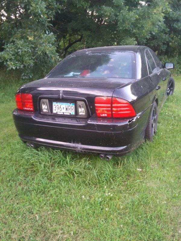

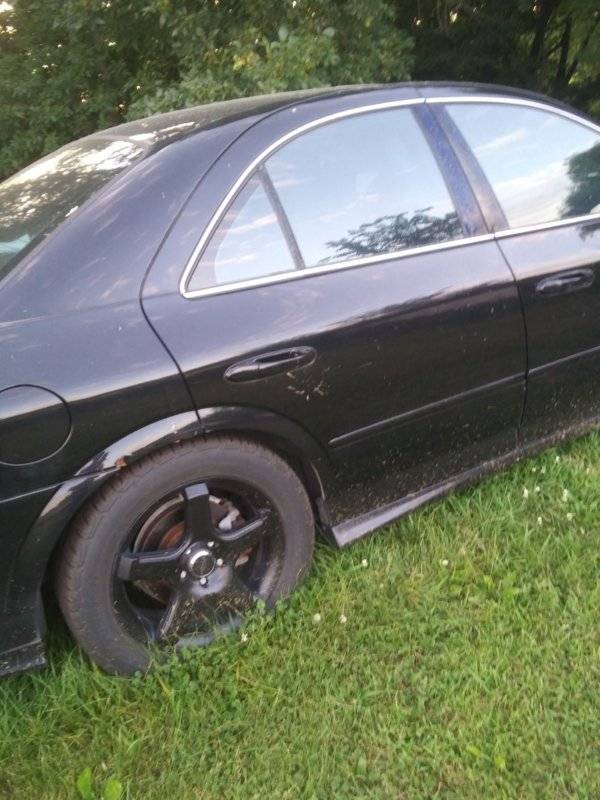

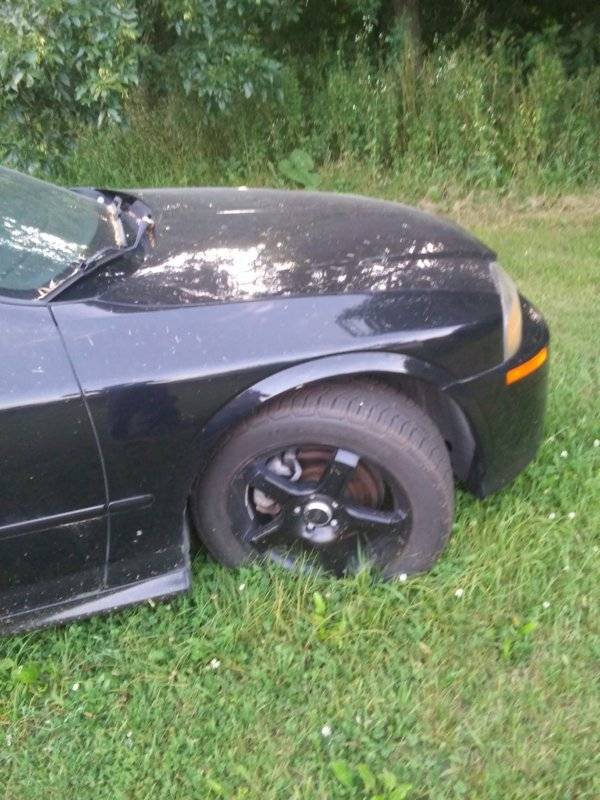

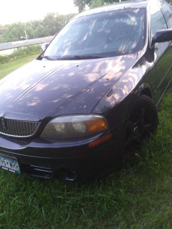

Does your 2002 LSE have any rust???? What about the front and Rear bumper covers????dents?????cracks?...I'm interested. I have a 2002 LSE with 104000 miles perfect except for little things body wise that beinga fuss budget I would like to fix but as you said.........the elusive LSE is nowhere to be found. You can email me at wallydufrat@hotmaul.com or call me at 519-752-5400.
Thanks
Thanks
Not perfect by any means ...thinking about repaintingvthis one and keeping it ...been looking for the black on black LSE for quite some time now ...probably going to murder it out completely;)
Lucky you........I need the front and rear covers only.....I'll pay you and you could get regular ones at any junk yard and they would look ok........It's up to you.
View attachment 828572486 View attachment 828572487 View attachment 828572488 View attachment 828572489 Not perfect by any means ...thinking about repaintingvthis one and keeping it ...been looking for the black on black LSE for quite some time now ...probably going to murder it out completely;)
and rear covers
