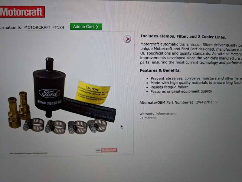

It this tranny line filter an owner add on? I can't get under my car right now to see if I have one.
Does it just go into the tranny line? Obviously this kit is a cut and insert. They do sell just the filter.
That could be the one. They were only added after certain kinds of transmission failures. It's very unlikely that your car has one. I haven't seen any on any of the LSes that I have looked at.
You'd have to cut one of the cooling lines to add one.

Yeah you wouldn't use that unless you had transmission issues. I bought that thinking I needed it, so don't be like me, I wasted money! I hope I never have to use that thing.... And if I am not mistaken you cut the cooler line and put that filter in place when you do have to use it.
Thanks to both you guys, Joe and Dale. I hear ya. Guess I can go without it unless it's already there.
