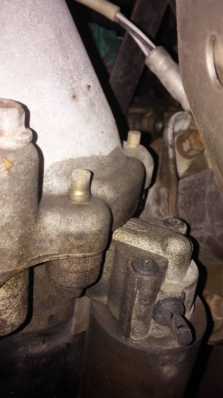

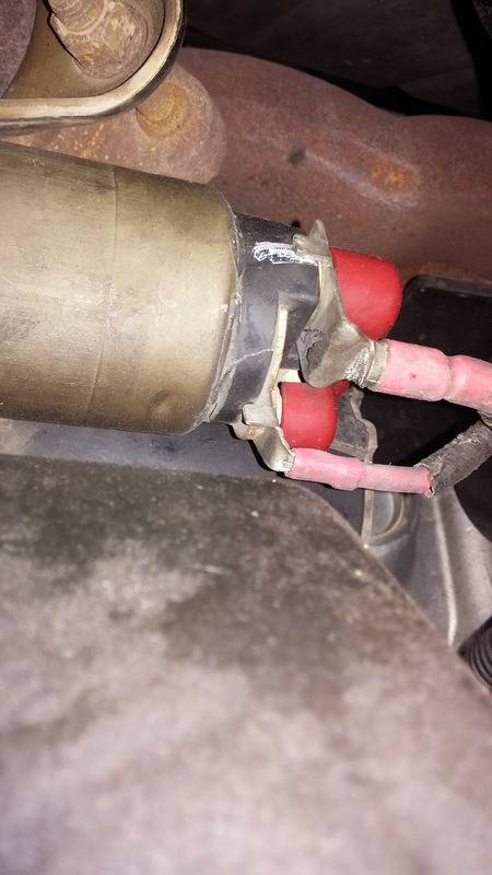

Looking at the solenoid on the starter, looks like it is cracked.
The solenoid is removable with the starter in place, right? A couple of torx head screws on the end near the mounting point?
Pull the starter so you can bench check it.....have fun with that top bolt.
Looks like I can get to it pretty easily with an allen key style torx bit.
