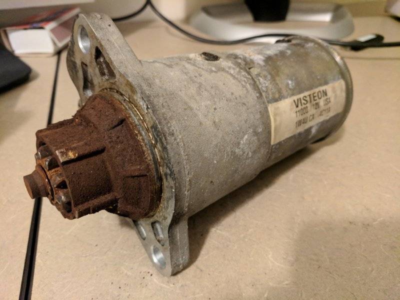

I ordered Motorcraft NSA6652N starter which was different from the factory part number but appeared to be compatible, and indeed it fit perfectly. Top bolt was tricky to reach and get on and off but eventually got it with some combination of wrenches/sockets. Car started right up instantly so that did the trick. So just wanted to say thanks everybody for the help.
Old starter was completely rusted on the inside part, not so on the body of it. But the two rubber things were crusty and broke off immediately or were already gone.. Is this a normal failure mode for starters?
Same pic is uploaded and linked here:
I wouldn't think so. Was your LS ever in a flood?
Nope, no flood. But I've battled coolant leaking and overheating issues in the past and again recently when I found oil in the coolant. Plastic cooling system components and some hoses were replaced around a year ago, and some more hoses again recently along with the oil cooler. I don't know how long it was being driven with oil in the coolant before another hose blew. In this time it developed a noise on startup that a mechanic told me sounds like engine bearings (sound happens on cold startup for a second or two then stops, presumably as oil pressure rises. Isn't heard or is much more brief if engine is restarted soon after getting warm).
So I've replaced the oil cooler and I've tried to run lots of water through the cooling system and gotten a lot of oil out... Of course there will still be oil lining parts of the system but only time will tell if it causes problems down the line. So that and the engine bearing noises basically have me in maintenance mode on this car, hopefully I can get more time out of it before I have to write it off.
Not sure if any of that can be related to the starter rusting.
