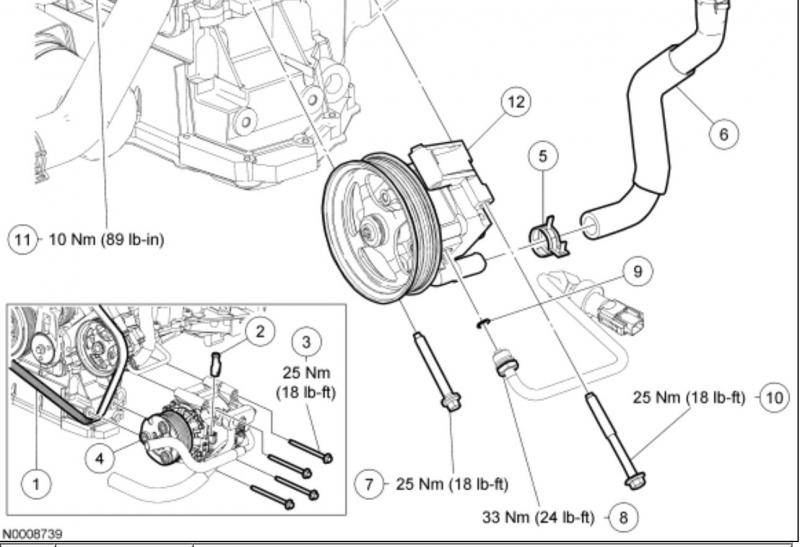

first things first, drain all the power steering fluid out that you can, I used a turkey baster in the reservoir. Then take a breaker bar and jam it into the square hole on the belt tensioner to relieve tension and get the belt off, then remove the bolts and pop off the pump. I remember it being hard to get the fittings out, need a special tool
this is what you're working with my man
The pump is ok it's leaking at the sensor on the back. Do I have to remove the pump to replace just the sensor?
