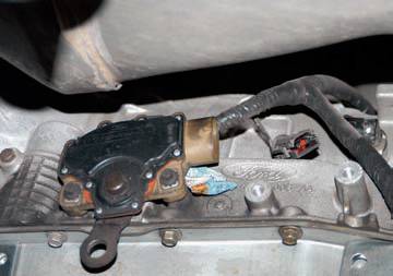

My first guess is the neutral safety switch which is really the shift selector. The first versions sent out were not well sealed up. A revision came out that has a orange gasket between the two halves, if an OEM part. Its easy to see. Even then, being so old the updated version could have failed by now. But if you look under and see the original switch, its very likely the problem.
Very easy fix.
In this image, you can see the orange gasket. I can not seem to find a write-up right now, but there are some out there. Do it with the car in neutral as the switch is marked for install in that position AND its sorta "adjustable", meaning the holes for both bolts are enlongated. Make sure marks line up and tighten down.
