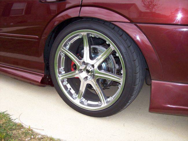

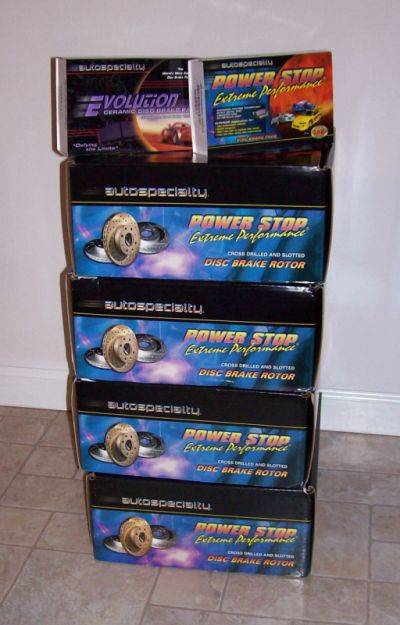

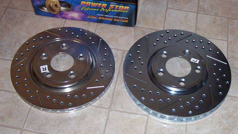

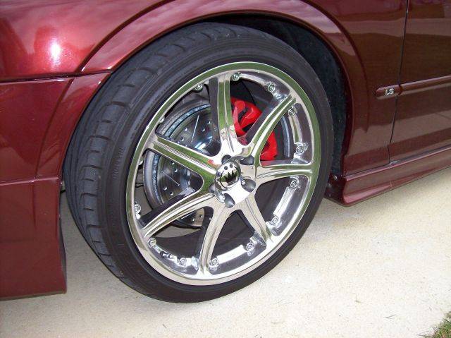

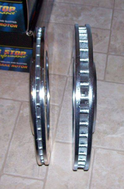

If you are looking for direct OEM replacements with BETTER performance. Try Power Stop Extreme Brakes. I have thier drilled/slotted rotors with ceramic pads. Love them.:D Run you less then $500 for front and rear with pads.
