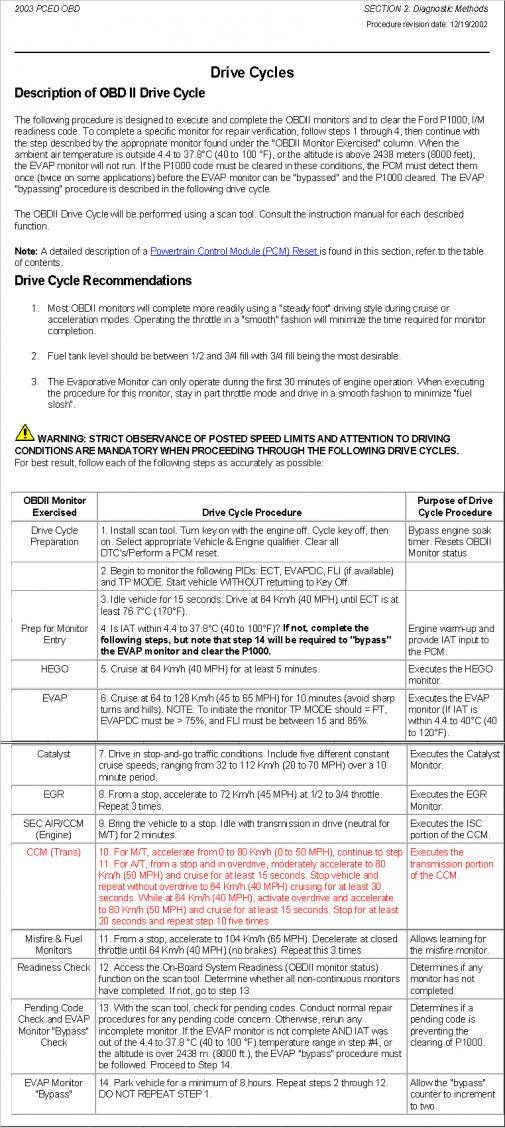

Lincoln LS:
Thats clearly inaccurate as it does not mention the A/C, the defroster, idling, etc

Lincoln LS:
thanks for posting. finally someone capable of having an intelligent conversation on this chirps in. you are correct in that i have no formal ford training with an LS, never claimed to have such training. do you?
in a perfect world where the car is never driven with anything affecting a shift timing being out of spec you are 100% correct. but if something affecting a shift timing is out of spec and driven for a period, the pcm will compensate and have bad parameters as a result. said bad parameters will not be reset the moment you fire the car up with a new component or sensor to correct the problem. if a car has 15k miles worth of bad data and then all of a sudden gets new readings from sensors for 20 miles, it is not going to correct at the snap of anyones fingers. 15k > 20. it will practically take a whole drive cycle to adapt with the correct parameters anyways, so why not expedite the process and ensure that bad parameters are completely erased by disconnecting the battery and relearning with only new parameters? why keep parameters from an old component or sensor which is no longer part of the car especially if it was out of spec (which is the only reason a normal person would replace something to begin with)?
targeted drive cycles are recommended after almost every repair in that book. and you are correct that the posted drive cycle is not complete by any stretch, but it at least touches the major sensors and is a good starting point for anyone looking to get back in spec.
