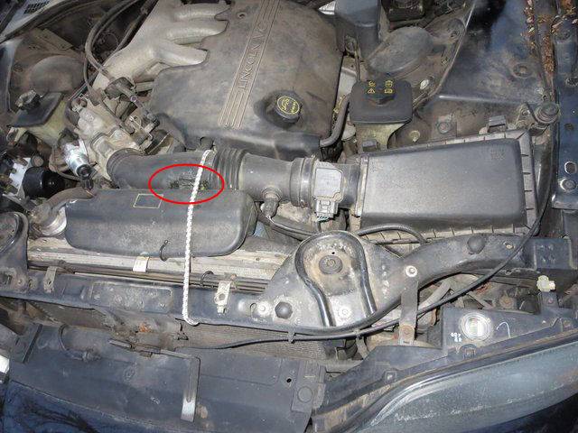

Put in a new fuel filter. Odd location. Will do the plugs next. Right side looks like fun. I take it the intake runner has to be removed?
It looks like the hard plastic hose from the MAF to the throttle body was damaged at one time and glued back together to the thing in front of it. If it's leaking air, could that be a cause?
Also, at the top of the picture on the engine cover there is hole. Is there supposed to be retainer in there?
Is that a ty-wrap stuck through a hole at the front of the intake air chamber? If so, that's a leak that would be at least part of your problems.
No, that's the other end of the bungee cord. Been to a few junk yards and couldn't find that same part. What years should I be looking for? V6 only? The EPC shows two part numbers, 2W4Z-9B659-AA or 2W4Z-9B659-AB, any difference?
Honestly, that silencer looks glued back on to me ... possible leak into system after MAF.
get the whole thing out, clean it up, inspect all around including bottom side, ensure no cracks for air to enter.
With that bungee cord wrapped around it, tells me, it's being held in place for the time being but there is unmetered air entering in.

BTW - you could get away without that silencer from what I've read, take it off, smooth out the portion where it meets the intake tube, plastic weld a flat piece across it.
Note ~ it's been argued back and forth on whether it was a good idea or not, silencer's job is there to stabilize the incoming air waves from what I understood. Others have removed it without issue from what I read in previous older posts.
