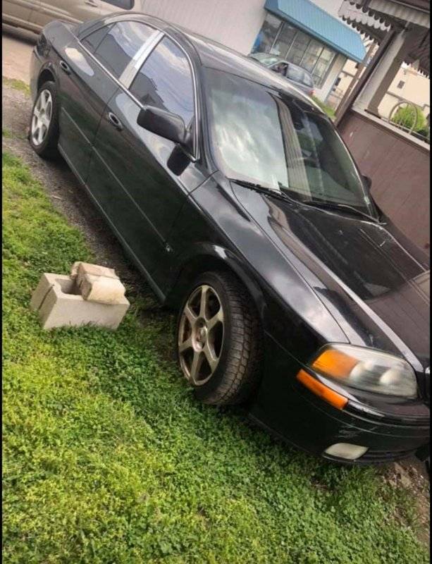

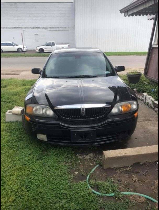

This is my latest find. And I just have got to say thank you Lincoln for problematic attitude having cars because I can attest that these cars are easy to diagnose and easy to fix. Every one I have had always has overheating issues because of a cracked thermostat housing running it low enough on coolant that a bubble forms and if you dont know how to burp these things you think its gonna be an issue. Fact.. most lincolns are owned by people that cannot afford to go to a dealership to have them fixed. Fact, most of the lincolns you'll encounter have brand new coolant parts on them. Fact, just because you replace the part it wont fix the air in line issue. Fact, frustration is my best friend. If they spend all this money on the parts to fix it and it doesn't the "mechanic" will push it on the "blown head gaskets" problem. No water in oil, no blown head gasket.
I just bought this clean LS for $250 as junk.. I of course knew what the issue was right off. I offered help and the man simply said, "Just take it away! I've sunk $500 into it I'll never see again.." I took the car bought a DCC valve for it, the only thing he didn't replace.burped the line checked the aux pump and fan and replaced the temp sensor just because and boom, the lincoln gods smiled on me yet again. I took it back to the man and showed him what I done and offered the car back for the same 250 and the parts and labor and he shook his head and said, "No, shes yours. But can we go for a ride. I never got to. " I handed him the keys and let him drive..
