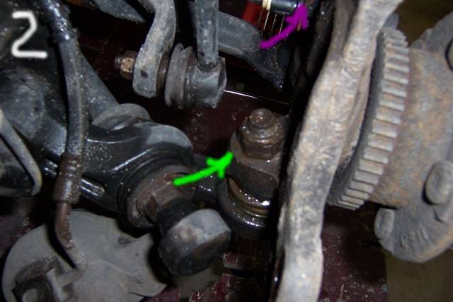

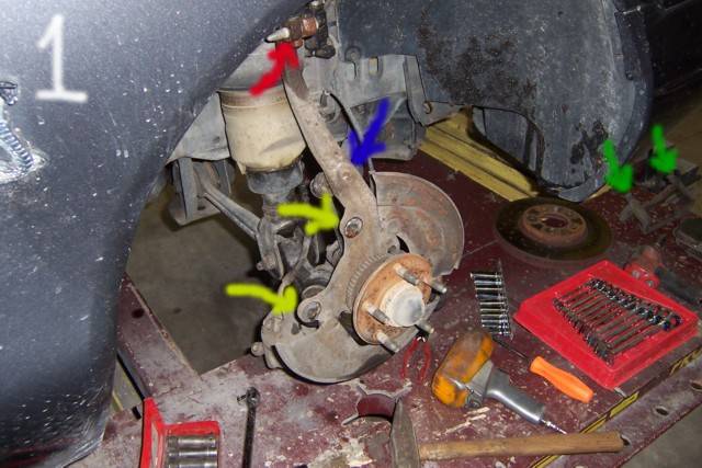

(Pics 1 &2)
1. Green, These are 12MM bolts, and hold the caliper assy to the main bracket. Remove these and then pry the caliper and pads off of the rotor. (keep check of the pads and reinstall them in the same side of the rotor they came off of)
2. Yellow, 15MM bolts are holding the caliper bracket to the spindle, these are also locktite’d so it will take some umph to get them off.
3. Purple, 10MM bolt holds the wheel speed sensor to the spindle. Tap this out and place aside
4. Blue, 15MM nut holds the swaybar link to the spindle, remove this and give it a good crack with a hammer to release it from the spindle. (leave the nut half on to protect the threads from a mis placed hammer blow).
5. Lime, 23MM nut holds the spindle on the lower ball joint, and will probably need some work with a torch to get it hot enough to break loose,(I know mine did). (remove completely)
6. Red, 19MM nut holds the upper control arm bolt in place. Remove this half way, and hammer the bolt out of the other side. Keep in mind that there is a little tension on the spindle from the air springs, the will kick the top of the spindle out once you remove the upper joint , but it’s nothing to be worried about. Once you have the bolt out, you may need to beat the joint out of the spindle, and can take some effort, but it will come out. Also, during this step you may notice that the sway bar link did not come all of the way out. It will come out ALOT easier if you wait till the top of the spindle is free and just pull it through the hole when you have enough room to do so.
Once this step is complete you should have something that looks like this…..(pic#3), you will notice I have the tie rod loose. I did this to allow me to photograph this easier. You can set the spindle off to the side and out of the way with the rod still connected. Now that we are this far, you should have the spindle kicked out at you and the lower ball joint ready to separate from the spindle. All I had to do is whack down on the joint while I kept steady moderalte upward pressure with my other arm. It took a couple of good cracks but it’ll go. Once that is done your ready to start pressing the joint out.

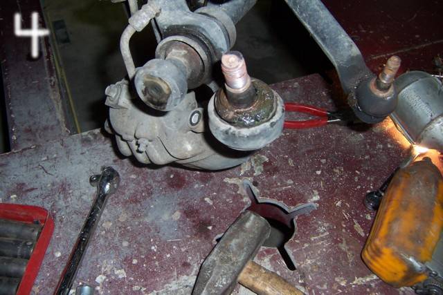

(Pic4)

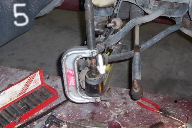

I have the use of a VERY well stocked shop to work in, but most of these tools can be rented at an auto parts store. If you have any questions PM me, or confer with someone who is in the know. I used a screw type balljoint press to push mine out and is really the only good safe way to do this job. (Pic5) I had some trouble keeping the press centered on the top of the joint so I cut the shank off with a cut off wheel to allow me to use a socket to keep everything square while I pressed it out. It should be noted that I was using a ¾” drive air hammer running 140 PSI on the ball joint press so you can imagine the force your gonna be putting on this to drive it down and out. Keep your body parts as clear as possible and PAY ATTENTION to whats going on!

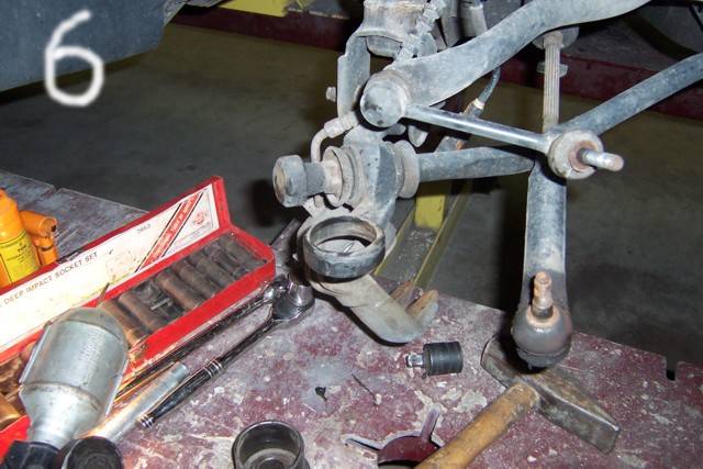

(Pic6)
Once you finally get the parts to break away from each other it will come out fairly easily, and the hard part is finally over. Clean up the inside of the bore with some emery cloth, and press the joint back in the way it came out, making sure to drive it in SQUARE until the flange fits flush aginst the bottom of the lower control arm.
