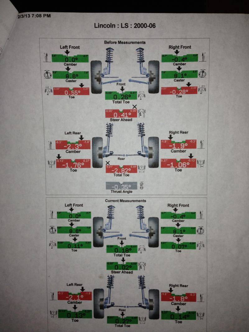

Yes they did the work for me. I do not know how firestone did the alignment with so much play. Here is a picture of the alignment results, they told me the rear wasn't adjustable.

When you look at the before and after toe angle of the alignment. It appears they removed some toe in angle so your steering is not going to be as tight as it used to be. Have them put the angle back to what is was before.
That "before" toe-in is way out, front and rear; that's why it's in the red. The LS should have pretty much zero toe-in.......
