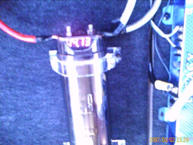

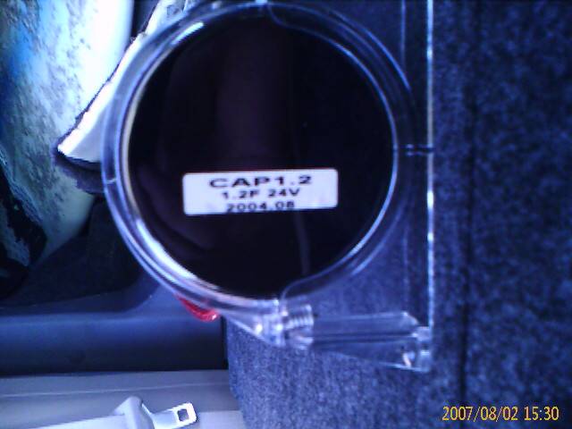

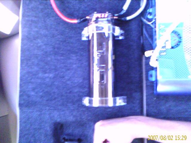

also i have replaced my front passenger window regulator (window fell in the door). and i have hooked up a 1.2 farad capacitor to my system. just thought i'd share. haven't been hawking the forums like i used to.

hows the cap working out? Mine still gets maxed out sometimes and my amp shuts off. I think i need a bigger cap...
the cap barely did anything. the lighting on the car dims less now with it. and the rpm needle doesn't bounce around with the bass loud.
