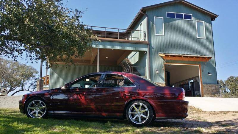

No more Ninja cup holders for you, looks good.
Yeah can you move that thing out of the way so we can see the shop more clearly!
+1 looks great! what I tell ya about leaving the cut springs in, nice!
no doubt about the cut springs. i've only ridden in one or two cars with cut springs
and they rode like arse - so i figured this would do the same. it actually rides very
well, glad i didnt swap em out !
Yeah, I should have just saved the money, cut the stock springs and eBay'd some Eibach stickers.
