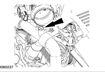

So right when i was feeling like I had it all wrapped up I noticed a wet spot under the car. I know some coolant came out when I pulled the intake so i did not worry too much.... however it was still dripping. I tracked it down to a plastic nipple on the part shown below. When I inspected it the nipple broke off in my hands....
I found lots and lots of info regarding the v8 and plastic cooling parts to replace however I have not been able to locate this part name or part number....also it looks like the 2 hoses on the side are attached permanently(if not please advise how to remove them). I have been poking around rockauto and other retailers and private sale sites however no one has a picture of the part in question. I am not sure what to order.
potentials are:
coolant bypass hose
http://www.rockauto.com/catalog/moreinfo.php?pk=384867&cc=1430714
"Upper" (yes thats the entire description)
http://www.rockauto.com/catalog/moreinfo.php?pk=384889&cc=1430714
Radiator Upper Hose (I think this is what I need)
I also need to replace the small hose that goes from this piece to the intake as mine has a nipple stuck i it... I am not sure if that is one of the above items either.
Any help is greatly appreciated... also while I have the coolant drained and the wipers and cowling off, I am planning to replace the degas bottle. what else should be replaced? again lots of info on the V8 was found but not much on the V6.

Here are the correct parts for the job... Im also replacing the belt as some coolant splashed on the existing one. I ordered from Rock Auto for Future Googlers, Its not the bypass hose its the upper assembly.
2005 LINCOLN LS 3.0 3.0L V6
GOODYEAR 4061073 Belt $ 24.79
MOTORCRAFT KM4741 Radiator Upper Hose $ 52.79
STANT 25290 (STN25290) Thermostat / Housing / Water Outlet Seal $ 0.43
STANT 14139 (STN14139) Thermostat $ 5.91
The dealer wanted 108.00 just for the upper. I got all the above shipped for less than that....
