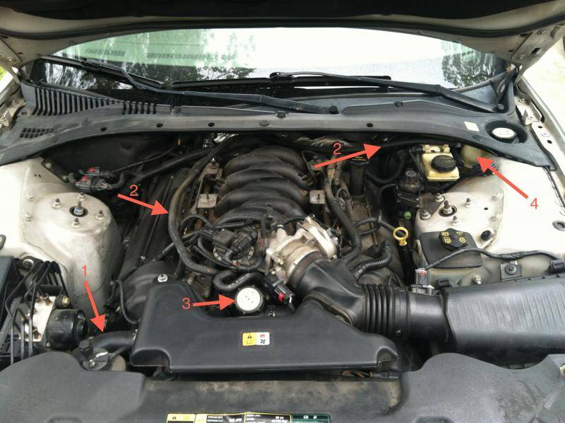

2004 Lincoln LS 3.9L with about 118K miles on her.
The radiator fan is working way too much (Loud) to maintain running temp on the car.
I have replaced the T shape hose (#1) OEM
Replaced Thermostat housing and Thermostat (#3) Aftermarket (Duralast)
Replaced the hose assembly OEM
Replaced the water neck assembly OEM
I also did a coolant bleed from the link you guys have provided in past threads
Here are a few details of what I have seen when the car is running.
1. Car does not overheat but FAN RUNS LOUD
2. T-Shape Hose (#1) gets hotter than normal (I think) (After I shut down the car I feel the hose and it feels like theres is some bubbling inside going on, Vibration type of feel)
3. Hose (#2) that connects to the degas bottle is hotter than normal (I think)
4. There appears to be condensation ( air bubbles ) in the degas bottle
-----Degas Bottle has some cracks but are not serious(I think)--------
-----Also when opening Degas Bottle (There appears to not be much pressure being released when opened---------
5. When vehicle is idling or rev'ed up to 2k-3k rpm's I noticed there was some bubbling effect in the degas bottle (too much movement inside) ( Also the bottle is very hot)

You have bubbling (coming from the engine bleed hose I am sure) because there is air or steam in the coolant. Air would be because of a leak. Steam would be because coolant is boiling in the engine. This could be because the cooling system isn't pressurizing due to the degas bottle.
Note that the temperature gauge needle will still be on the center line when it is too hot. It doesn't move past the center line until it is way too hot.
I've also seen coolant boiling (and bubbling in the degas bottle) when the system wasn't filled and bled correctly.
