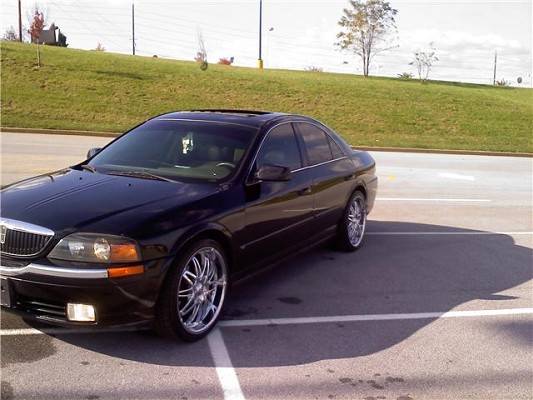

Alright well I found this 2000 Lincoln LS V-8. Has small tear in seat, I gotta buff the paint a bit, Neither anything I cant handle. Its got 20" rims, 95,000 miles... $4000In dash DVD player, good stuff what not.
