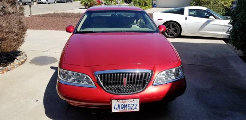

Hello everyone! Picked up a 1998 Mark viii a few days ago. Original owner, 95 y/o WW2 war veteran, 82k miles, all service records since new, recent brand new tires and brakes, with brake flush. Having a few issues though. Smell of fuel inside cabin, ac stopped working after I cycled it from heat to ac a few times to check it on test drive (blend door?) And neon trunk light does not go on.
