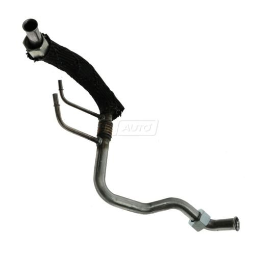

I have heard of the EGR tube breaking. That would be a large exhaust leak in that area as well.
Thanks for the reply, MooJohn! I'm mechanically inclined, but for the life of me I can't figure out how to get back there to check anything. On the PITA meter, how big of a job is it to repair/replace the EGR tube?
I've never had to do it and I hope to never need it :D
It looks like a simple but PITA job because of how hard things can be to reach. I've attached a pic of the tube (stolen from ebay) that will let you know where to start looking for a leak. The flex section looks like a prime candidate for issues to me.
Nobody listed the tube for a Continental but this seems to be common to all the OHC engines.

That is a GREAT picture! Thanks for the tips, MooJohn. :Beer
