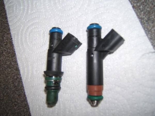

I have the set of injectors that came out of the 4.0 AJ27 engine that I'm building. My first thought was to compare them with the 3.9 injectors. (It would be nice to compare both kinds side-by-side to see if they are 'switch-able' before tearing into the top-side of my daily-driver 3.9.) I don't have much doubt regarding similar flow, but there may be some physical difference that'd preclude this swap.

well - anything is possible.
On the stock injectors - you can see that the bottom o-ring is actually an inch up from the tip - on the body, and that the inch below the o-ring pushes through the manifold. So a standard injector would not seal up right - nor would the tip protrude enought out the bottom of the manifold.
if you could get by those issues - then you would have to cap off all the lines running into the air rail - and the feeder on the IAC.
I just tried fitting a standard EV6 into it - maybe with enough pressure down on the injector the bottom o-ring could seal - but the tip is still buried up in the manifold too much (maybe the spray would clear it...)
