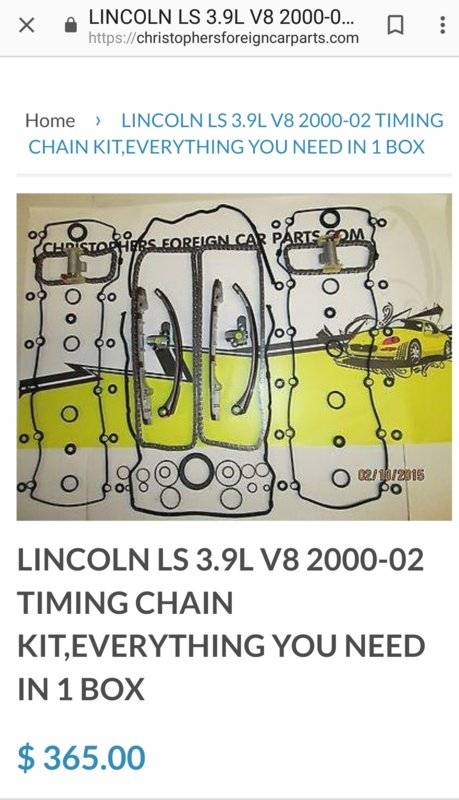

Planning on buying this complete kit from Chris foreign auto parts. At only $365.00 seems like a solid investment as I plan to keep this vehicle for the long term. I already have new COP's and plugs . Is there a recommendation for engine oil type and weight for all year drivability. Also gear or transmission fluid. I have driven this vehicle before transmission was smooth and constant though the drive. Would it be advisable to just top off or drain and replace the trans fluid or should I leave good enough alone?.
If the engine is a true 2002 version this is the one your need.
FORD THUNDERBIRD L,V8 2002-06 TIMING CHAIN KIT,EVERYTHING
Call Chris before order though, he is a good guy and I am pretty sure the one you have picture has the pre may bike chain style in it. But the rest are upgrades like he says. Main thing is figuring out which of the two versions is the engine your getting.
