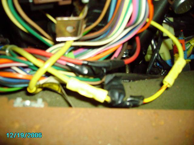

Yellow wires
I went underneat the stearing column and found a yellow wire that had been electrical taped together. I thought that I nailed the problem, but then realized that there are 2 yellow wires. I'm assuming the yellow wire that was spliced is not the airbag wire, because the other yellow wire had an airbag warning tag on it. The wire went into a harness with a orangish colored pin in it. The harness also had a metal clip-looking thing on the back of it, like it was suppose to be attached so something, but it wasnt. Other then that it didnt look like it has been tampered with, or like it was shorted.
Do you know what the 'other hellow wire is? It looks nearly identical to the airbag wire.

Here is a picture of the wire that appears to have been repaired:

The code could also be caused by a defective SIR coil assembly. The other yellow wire cold be for the passenger airbag.
