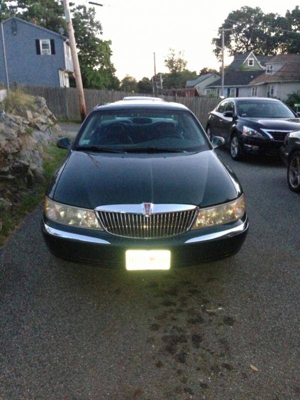

Just bought this from my uncle 98 continental with 85k. Anyone have any tips on how to make these headlight look like new
Here's some pics
Nice car! I tried the Meguiars kit from Wal Mart. It came with sand paper, plastic polish, and a buffing wheel for a drill. It was $20. It worked very well for me.
fine looking Lincoln, good scroe!
i take my headlights out, put my drill (or buffer) in the vise, and run the lights across the pad that way, plenty of Meguiars Plastix, seal/uv protect after
1500 and 2000 grit sandpaper, then polish with some PlastX. Always LOVED the instrument cluster on the Continentals, just beautiful!
a old trick is to use tooth paste especially if theres a haze on the lenses tooth paste and a paper towel in a swirling motion starting from the center working your way out
