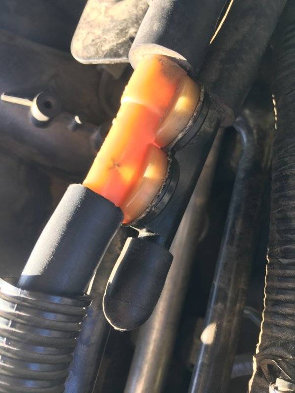

Ugh, I’m an idiot!!! Yes, accelerator works. Just still have a vacuum leak coming from this area with the culprit being the hose to the PCV valve. Do I have to get the whole harness or can the individual hoses be replaced?

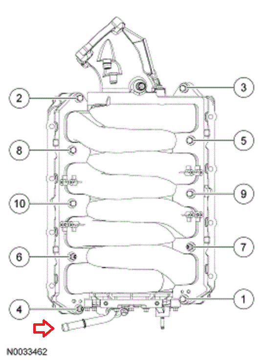

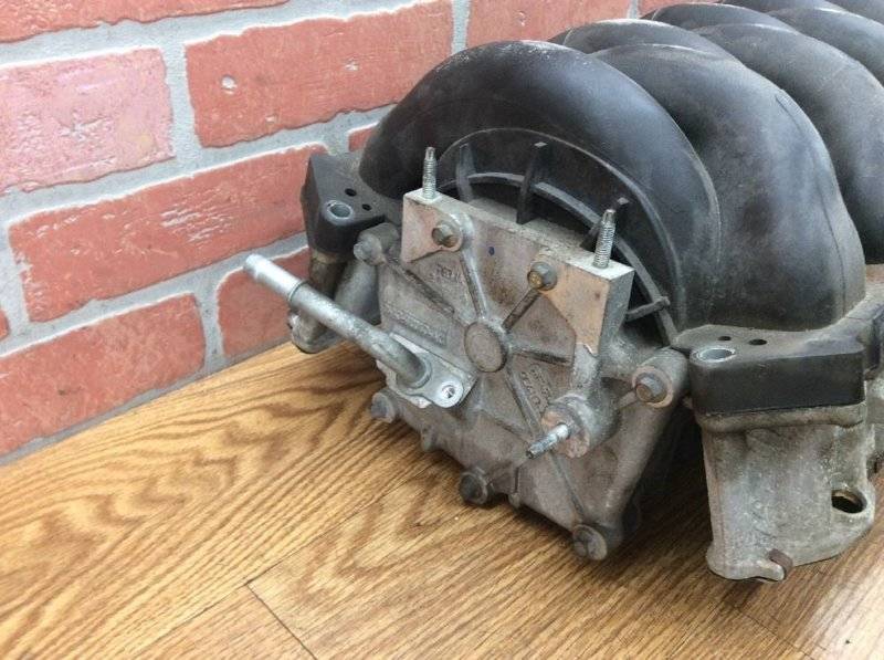

And, how do I get to the PCV connector? There are a significant amount of wire s attached to a harness. I presume that comes off...
Lets be clear here. That is not a PCV valve. The V8 has no PCV valve.
The valve in question is for vacuum supply to the brake booster. At high engine vacuum (idle, deceleration, ...) it sends vacuum from the engine to the booster. At low engine vacuum (acceleration, WOT, ...) it sends vacuum from high speed air movement across a venturi on the intake in front of the throttle to the booster.
Ford calls it a one way valve assembly. Part number F7CZ-2365-CA, but listed as not available. You can still get the hose assembly with the valve in it (you probably need all the hoses by now anyway). Part number 3W4Z-9C490-BM. Should be about $33.
If I remember correctly, there are two nuts that hold the wire harness on the back of the manifold. One facing up that has to be removed completely, and one facing the rear of the car that only have to be loosened. Then lift and push back on the harness holder. Sounds easier than it actually is.
Thank you so much!!! I can now hear a hiss from the hose that connects to the back of the engine And having fits trying to figure out what it connects to.

I think I found the area of the hose that is leaking and put some duct tape on it as a short term measure til my replacement comes. I have been reading up on fuel trims (short and long term). Below is a link to an article that seemed to explain things well.
My short term fuel trim was up are 25% and my long term had gone to 30% and that is what threw the codes (at least that is what the log had showed). With my duct taped hose, my short term trims were in the low single digits both positive and negative, e.g. -3.1% (rich) to 3.5% (lean). These values have my long term fuel trim in the high teens (18-19%) to low 20s.
