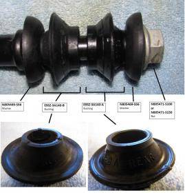

looks like all i really need is the E9SZ-3B282-B (F3LY-38282-B) Sleeve.jpg outer sleeve.. just one the back sleeve in the pic (11) will take both :)

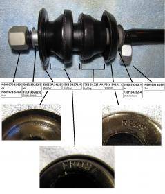

I have no idea how you could get the washer backwards. It has "THIS SIDE OUT" stamped into the damn thing.
I had both washers marked with a silver marker pen also.
Pretty much setup so a 12 year old could place them in the right order.

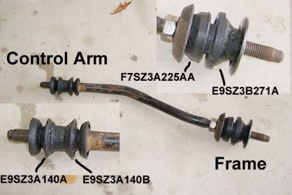

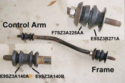

It is really hard to assemble these wrong.. For one Ford was smart and each is labeled clearly... I am sure I will mess it up somehow
Lol, Jim, I'm sure you'll be ok. Check out the pictures below, for a quick reference.

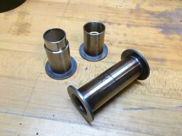

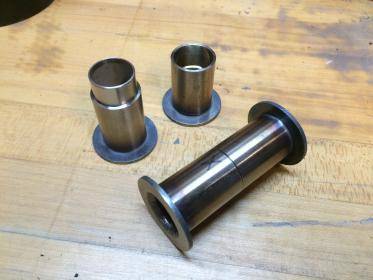

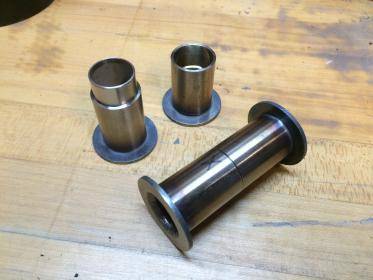

I've got a set of my stainless sleeves on their way to Jim (Frat-man-du), which should be arriving today before noon.
For anyone reading this in the future, I almost always have the OEM washers on-hand to go with the sleeves, if necessary. I've included a picture of the sleeves I make as well.
As a reminder, the forward (flat-ish) washer will need to be drilled slightly larger to a 1" inner diameter.
