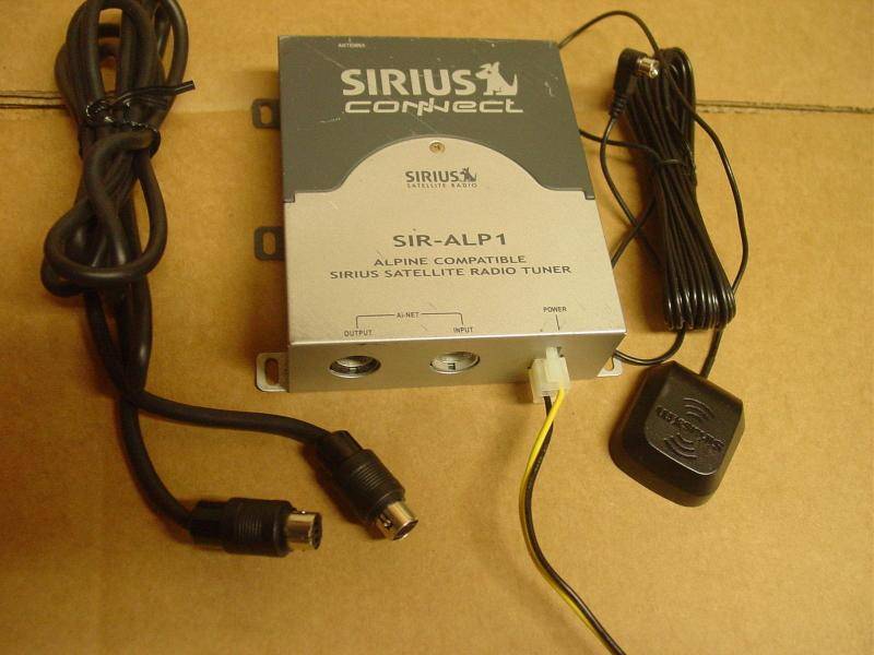

This is what is installed in my Lincoln...I think and I say this because this is what was selling back around 2005...Wondering if anyone knows for sure if this will fit on a new aftermarket Nav unit.

while that may have been installed by a dealer (doubtful) it surely wasn't installed by the factory.
it is an aftermarket sat tuner made for aftermarket alpine radios (Ai-Net enabled), and for it to be used with the factory radio, there should have been a translator module that converts from the Ai-net connector to the factory connector (also usually handles all of the data translating).
unfortunately, a few years ago after the merger, now there is a different manufacturer making all of the sat tuners, then now all use the same connectors and each radio "speaks" the same language. this will not work on any recent models released with in the last few years... the only radios this would work for would be any alpine radio with Ai-Net connectors and the "Sat radio ready" logo and wont work with any radios with the "XM Ready" or "SiriusXM Ready" logos

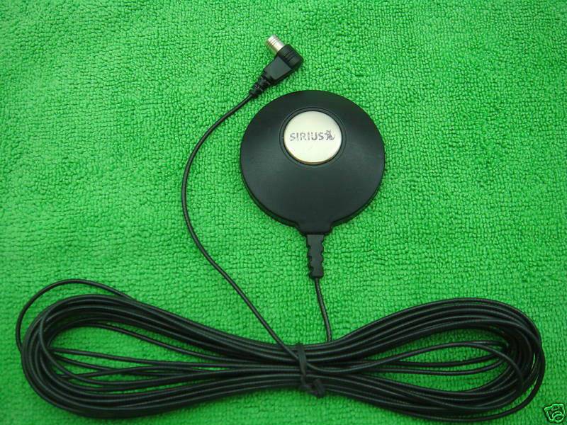

This is what is installed on the top and rear of the trunk lid.
