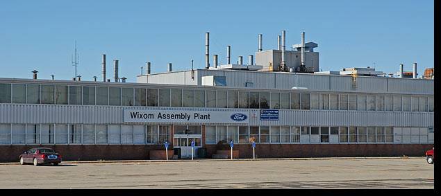

I'm pretty sure that all LSes were made at the Wixom Assembly Plant.
The date (month/year) should be on the sticker on the door.
Correct on both accounts. Probably the most distressing thing I saw when watching them build the LS was seeing the guy drive the car off the line and right onto a dyno. He then floored-it for almost a minute! YIKES!!!! So much for breaking-in an engine delicately!!
