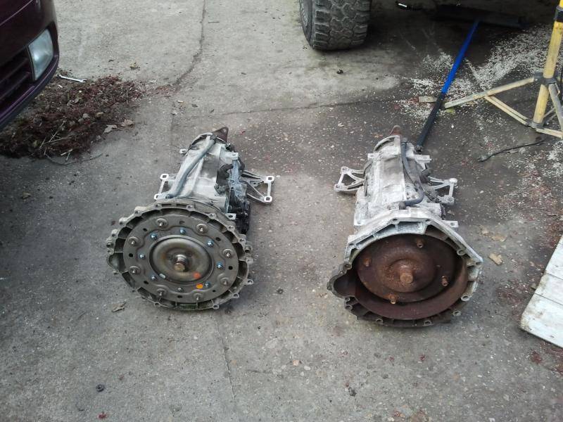

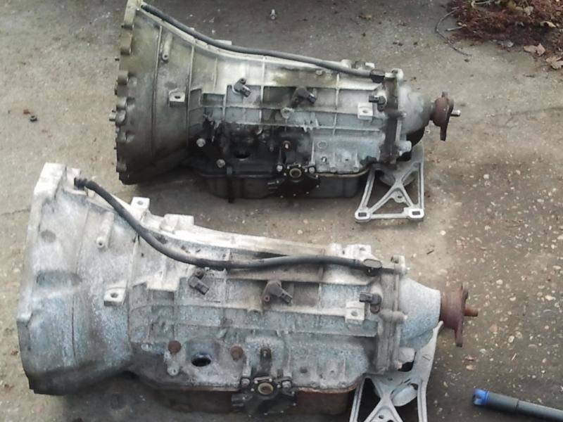

I was changing out my transmission today and I think I'm screwed. The bellhousings are different but both came out of V8 vehicles I was told. The tags on the side of the trannys state 160 (out of my car) and the one I purchased states 150 (purchased). Here are a few pics.
In the second pic tranny2 the one on the left came out of my car which is a 2001. The one on the right came out of a 2000. Besides the bell housing that is the only thing I see different. Will the one from the 2000 work?

I'd say the one on the right came out of a V6 not a V8. The one on the left is devinitely the V8. you can tell from the 300 bellhousing bolts it has.
The one on the right is definitely a V6 transmission. It looks pretty rough, you were going to put that in your car? You need to make sure your replacement is from a 2000-2002 LS, as the 2003-2006 will be different. As you have found, it also has to be out of a V8. The easy indicator is the torque converter. The V8 torque converter has eight studs and an adapter plate as you can see in yours; the V6 is a four stud converter.

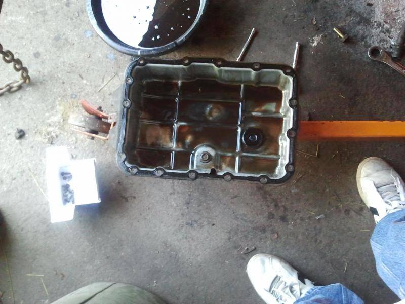

Here is the pan off of the tranny. Fluid was a little darn but not burnt with no metal shavings anywhere so I'm doing the rebuild following the thread posted by Mikeswood. Parts should be here Monday so lets see how it goes.
