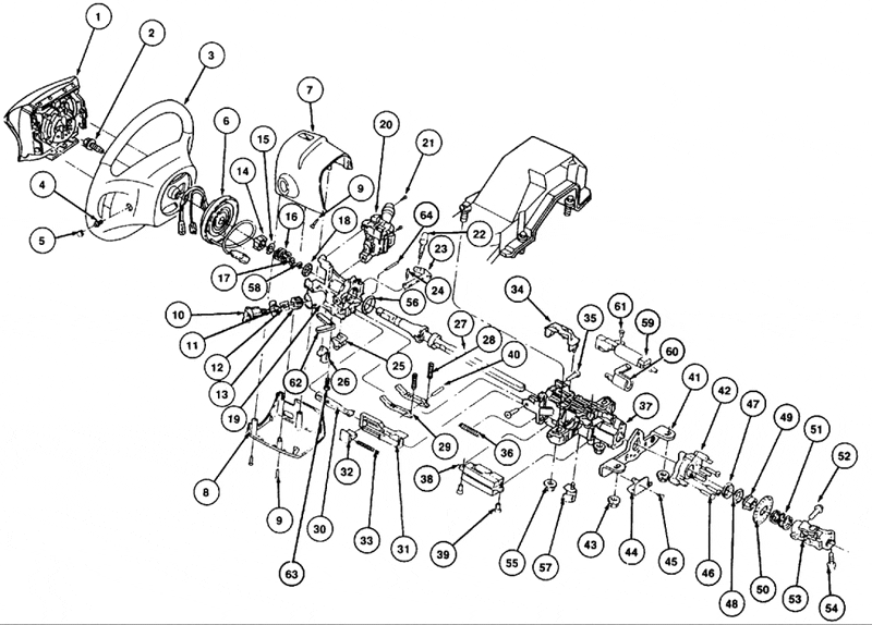

I need to replace the turn signal switch in my Mark. But when I went to do this about a week ago I could not figure out how to remove the tilt lever and the ignition lock to get the collar off. Is there some trick to this? Any help would be much welcome.
Cool... I did not know that about the ignition... But I think my tilt lever is welded in. lol I could not unscrew it... Time for some Liquid Wrench!
Is This Helpful?

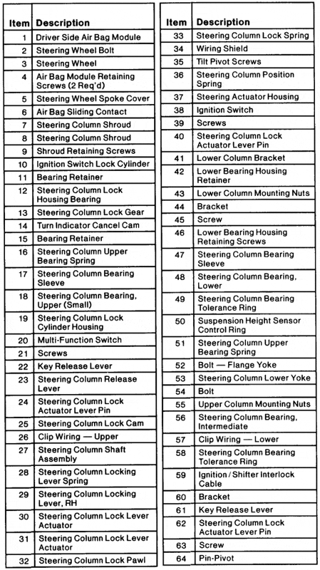

1996 Mark VIII Steering Column exploded view:
The tilt lever is very tight. The ign switch needs to be in the on position to get it out with the pin.
