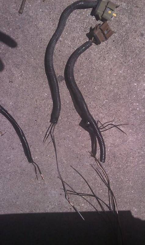

pushing the car back out of the garage in the proces of painting it this harness with 3 attatchments got run over and ripped from it's wires. I'm trying to wire it back up but there are 3 solid black and 2 solid brown wires. I'm wondering if there is a wiring scheme for this or if someone knows what I need to do to get it wired up. Here's a pic.
Ones the blinker, one low beam, one high beam,
Get a volt meter or a test light, check at the harness still ON the car, use each system independently, that will tell you which cluster is which...then wire on the appropriate plug for that light...
Will update colors of plugs in a sec
totally wrong, one is the side marker/ blinker light, one is the light that lights up the side of the road when you make a turn, and one is for the little tiny 194 side blinker bulb in the amber section of the housing closest to the front wheel. this is a 97 or 98 correct?
Yea. Bad97LSC is correct. I grabbed a voltmeter and am in the process of doing this. I thought it was a harness for the headlights so I checked against the ford diagram ( at ford dealership ) once I figured out what it was for I grabbed the voltmeter.
