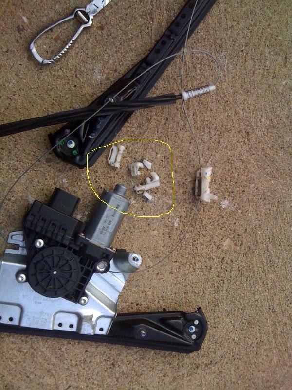

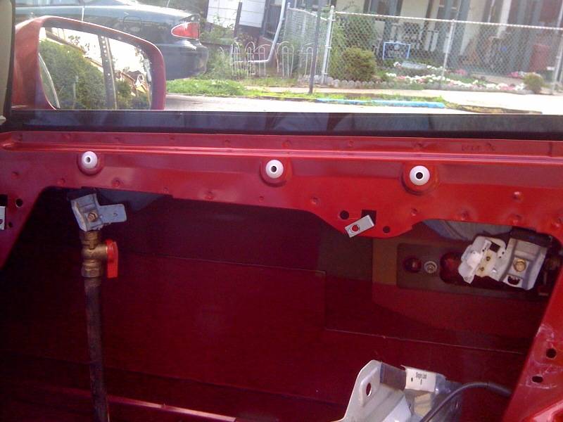

I ripped it apart yesterday and discovered that the cable was off track and that one of the WHITE plastic pieces that anchors to the bottom of the window busted into pieces. So I'm assuming that these can't be replaced and that I have to buy the entire regulator unit? I used an old pipe to prop the window up and then used zip ties to keep the window in place until I figure out what to do here.

pic of the plastic bracket
the plastic bracket that shattered is circled in yellow and slides onto the part which I had supported with the pipe.
I spoke with the stealership, and he says the brackets come with the regulator and motor...so yes I see now why everyone is saying it's the regulator that is the problem even though the motor and all is good. They quoted me $106.08 but won't order it until I come in and pay for it....I guess I'll be riding with the AC for a while....
