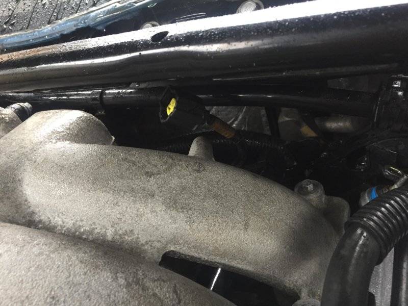

    Just threw in new coils and plugs and buttoned everything back up and noticed this little guy just hanging out behind my intake... I didn't take pictures or have the book so hopefully, someone is able to help me out, I don't really want to take the intake off again.
    Thanks in advance!

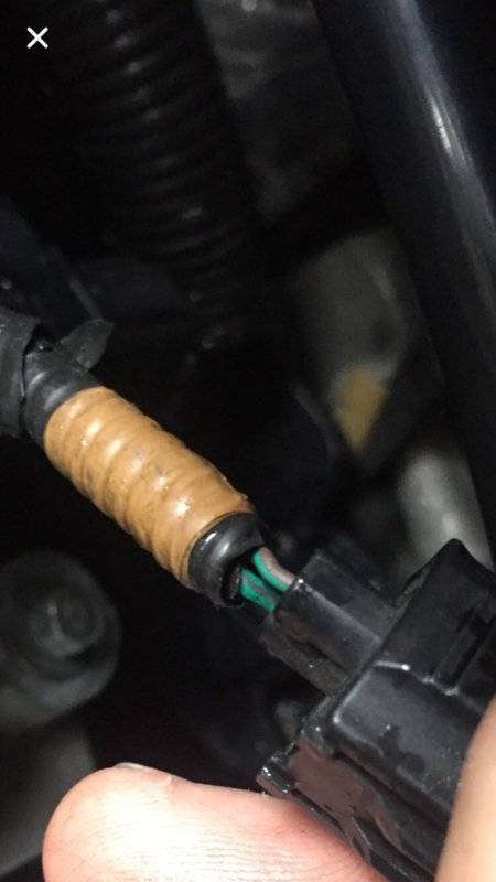

    Heres a closer look at the color of the wires

    It can't be too many things. I am thinking either the intake manifold (tuning?) valve or the EGR differential pressure transducer. As long as your cowl is off, you shouldn't have any trouble plugging it back in.

    for what it's worth, the green/black and brown/green wires identified it as the intake runner manifold control solenoid 2 on the back of the intake manifold

      Yeah you helped me out big time, running deadly now
