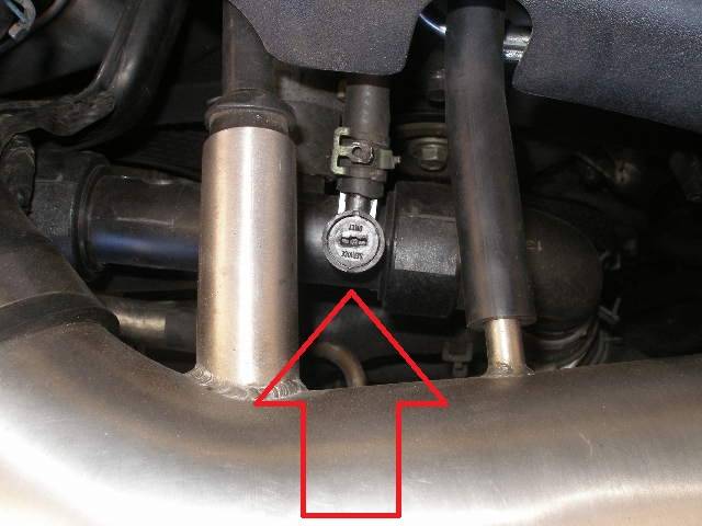

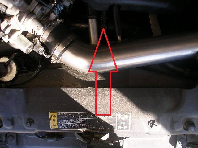

Need help ASAP broken petcock
Where exactly is this air bleed?
Heres a few pics. Let me know where please.

Please take a picture of the front center of the engine, where the bleed is. It's somewhere off frame to the left of the pictures you took.

Your picture shows the correct location.
LS4me: that's the heater air bleed, which both the V8 and V6 have. We're currently hunting for the V6-only engine air bleed.
02v6ls: roll up to a parts store, pull someone out there, point at the fuel fitting and ask them for a cap. It has a schrader valve, like tires, so there's no harm to not having a cap. But you do want to keep crud out of there in case it needs to be used. If the stem is the same as a tire stem, then this will be really easy.
Take a picture of the same area as the top picture, but instead of taking it with the camera in front of the car, take it with the camera near the windshield, pointing towards the front of the engine.
Alternately, if you'd take a picture like the bottom one (with the air intake hose removed) but a little to the right, like the top picture.
It's sticking up on the tee section of the big radiator hose just behind and below the air intake hose.
