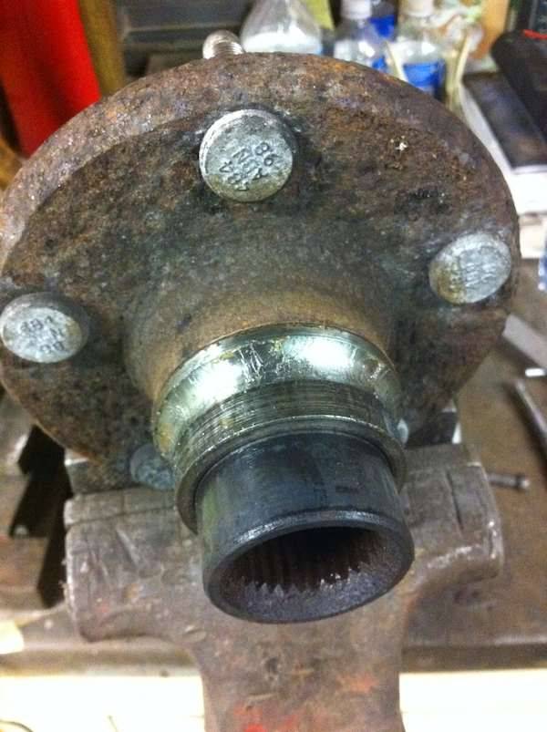

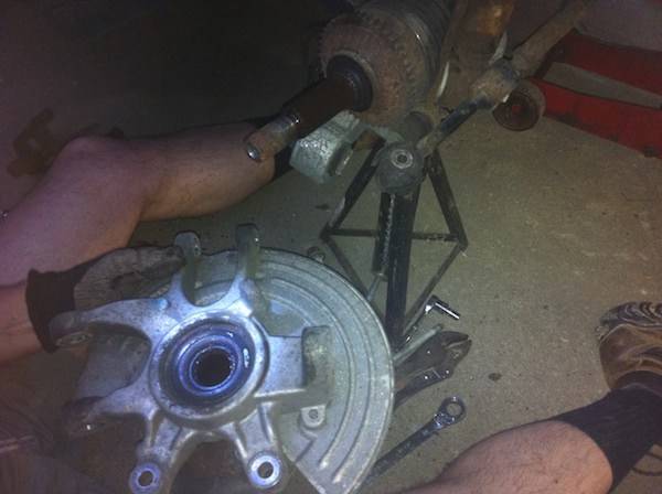

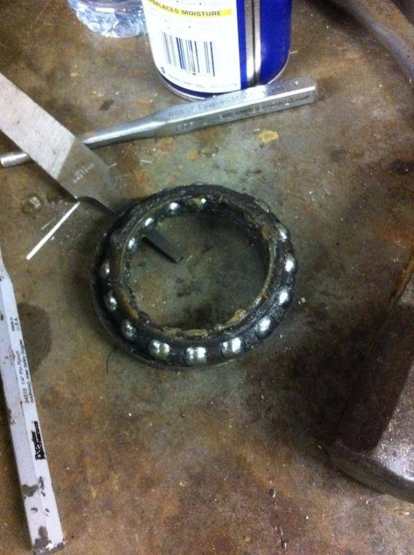

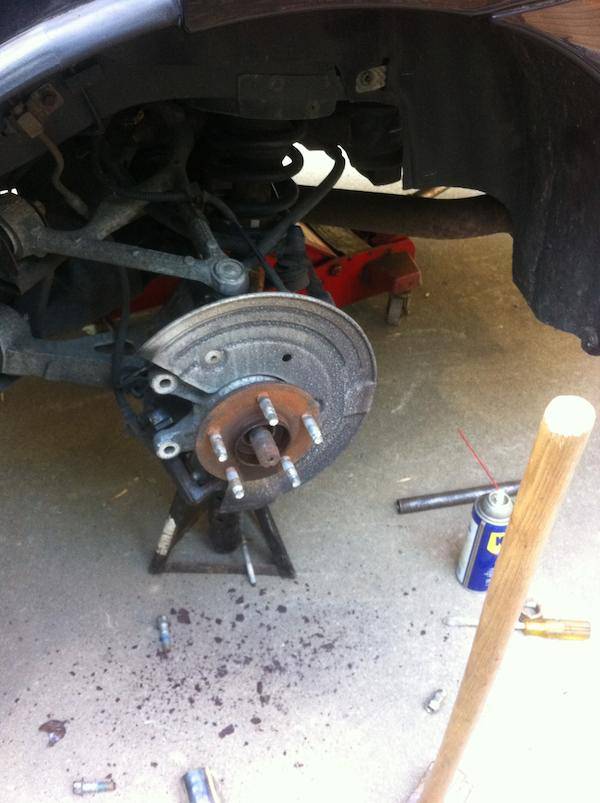

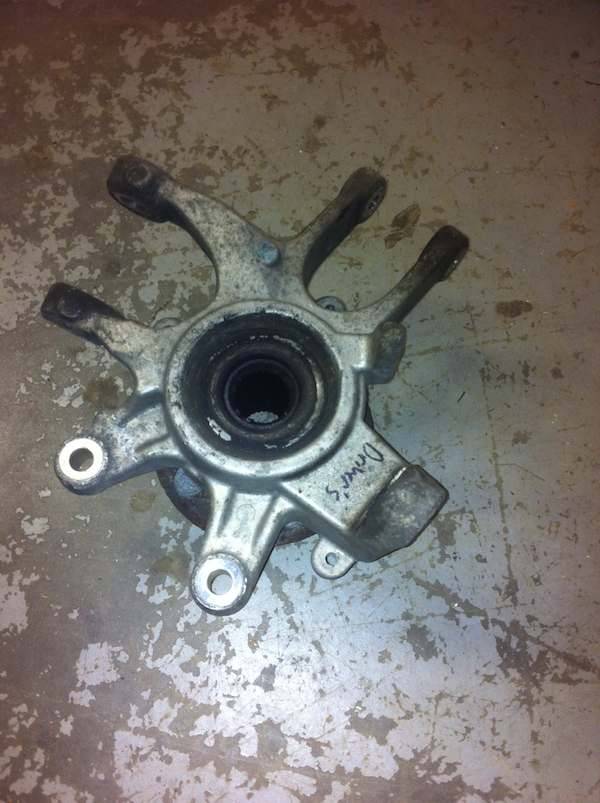

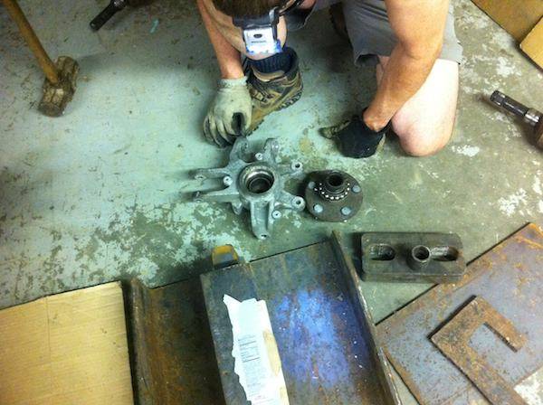

What's the deal with the Lincoln LS wheel bearings? I replaced a front wheel bearing hub just two months ago and all was well and quiet again. Then last week I started hearing some noise which sounded odd. I jacked up the car today to do a visual inspection and the back wheel is extremely loose. So glad I didn't drive to work today... it could have locked up or maybe fallen off!
What surprises me so much about this is the lack of warning. It only made a faint growl noise for a few days before getting violent!

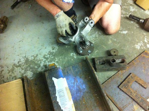

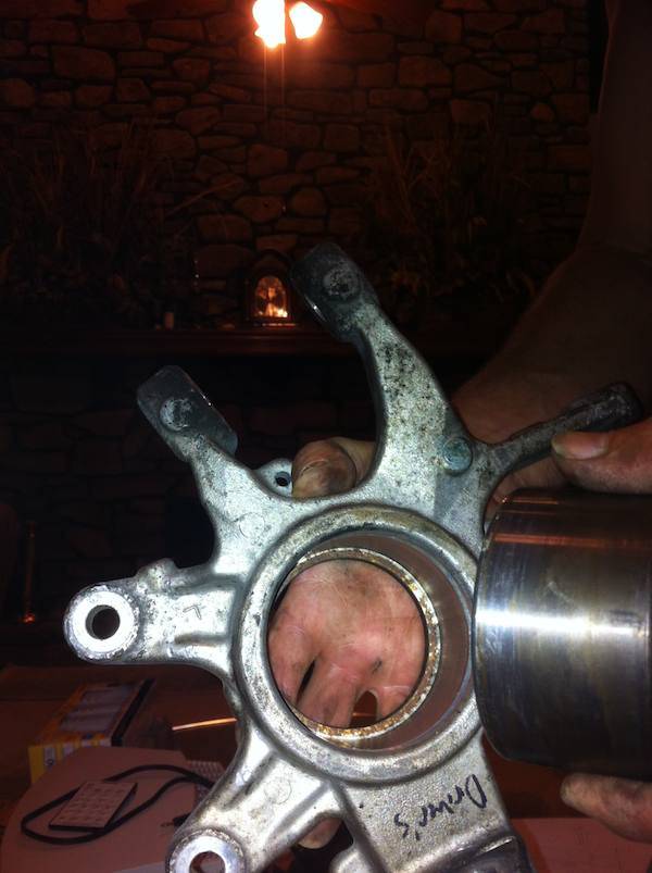

Where can I find parts to fix this? I'm a little worried about finding a good shop to press in replacement bearing in the hub. Is this a good solution or should I source out the entire hub assembly? I would imagine that any little metal shaving or burr left in the hub during removal/installation would shorten the life of the replacement bearing.
