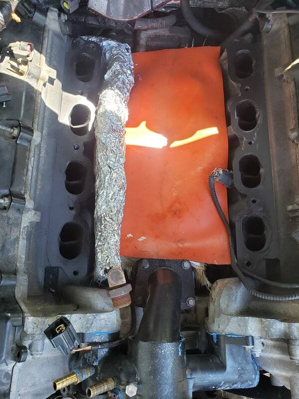

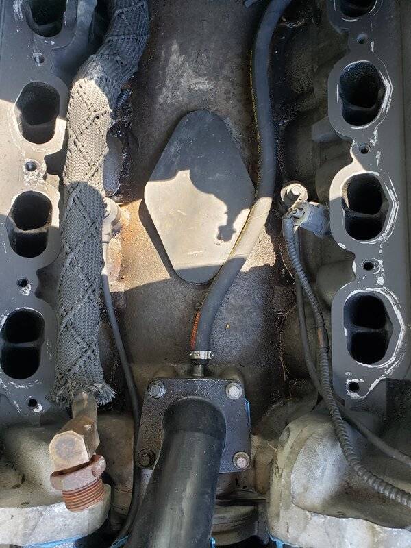

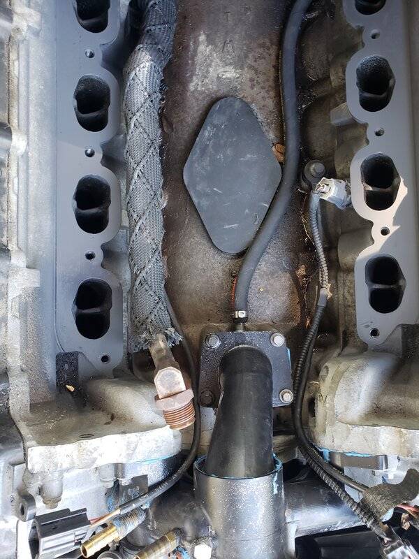

The valve cover gaskets when replaced be coated with a thin skin of Permatex Ultra Blue on all surfaces. The head valve cover seal surface polished clean with fine sand paper to insure a good seal. When dipstick needs to be reseated, a extra surface area is needed where it inserts into the lower engine where a small oring originally is used. This tube o-ring leak with some use and to access requires ps pump/bracket to be removed & is still a chore to clean and reseat. When reseating place a one inch dia rubber disc/0.5" high with 1/4" center hole & new oring to seal the tube entry with sealing silicone. This method worked with about couple hundred thousand miles with no leakage. The center valley coolant tap that feeds the throttle body is a job requiring removing the intake manifold. I found a hydraulic hose worked on the valley coolant tap and clamped with a PEK clamp for a permanent clamp. The hose was clamped on ds rear head face and looped back to the front ds head face coupled to a regular epdm 1/4" hose the hydraulic steel braid hose was clamped down as stiff as it is to allow an easy staight hose into the throttle. The egr tube was covered in a silicone fiberglass wrap to insulate the exhaust stream and keep the manifold from heating up. The spark plugs are NGK iridiums & the coils are Denso oem units. The coil covers need extra sealing with silicone. Clean the white cover seal and apply high quality silicone on the seal about a 1/4" bead all around then clean/cover with valve cover coil area with Saran plastic film to prevent silicone adhesion to the valve cover. Place siilicone applied coil cover lightly in place and install 5mm screws snug not tight. Let silicone to cure. I found water leakage from the ps valence to allow water on the valve cover.. the front main seal can be fixed with the plastic seal case filled with silicone to strenthen the flimsy case. This was one of many solutions to the leak i found . I saw on YouTube Dave's Auto a sized ring of the front crankshaft id and the front cover seal id to align the case. Must remove the dowel pins to align the front cover during silicone curing.

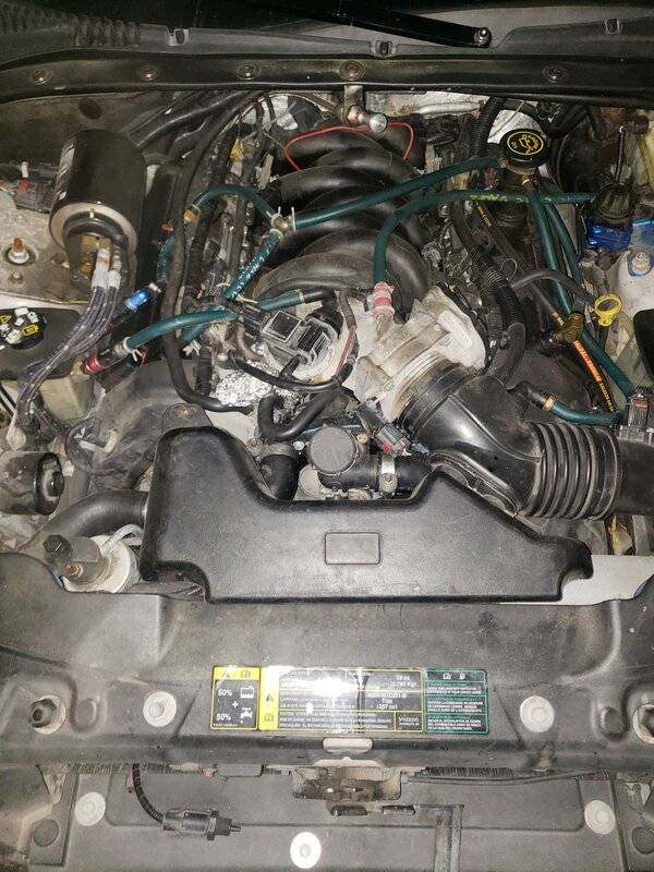

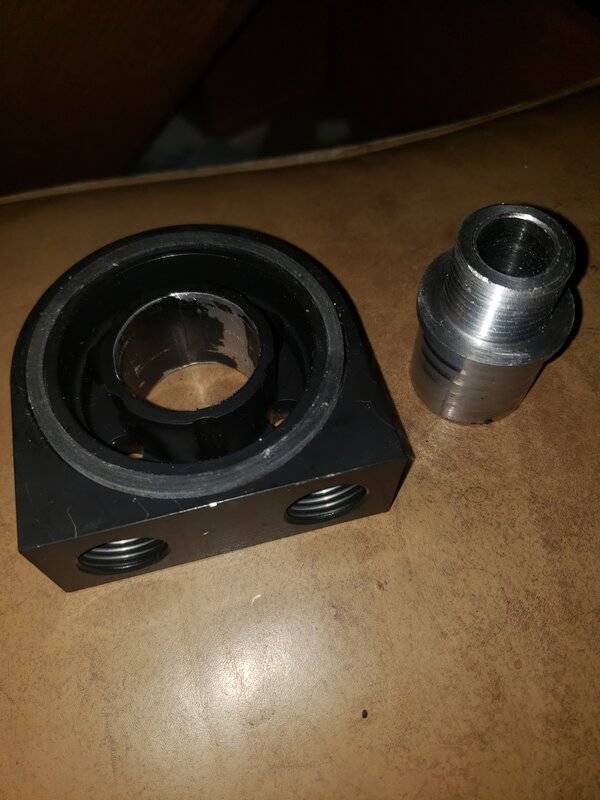

When the motor is out get the fuel injectors cleaned. With a engine of 120k, blow-by could an issue with excess intake oil. To controll the oil mist i rerouted the engine vent tubes from the valve covers through a 2000-2002 LS hydraulic resevoir as a oil catch can. I used aluminum air line quick disconnect fittings on the hydraulic resevoir able to remove oil mist on ps bay and pour oil back into the engine. The input vent air in from behind the mass air unit to the oil fill tube. The ds valve cover vent hole can be converted from original push on type to npt type while resealed valve covers operation. The ps valve cover had a orifice of a 0.03" hole which was moved from the ps valve to the intake manifold vacuum tap from the converted catch can. There is a Amsoil by-pass filter installed. It filters to 2 micron. I had to get a oil distribution block made to run the high pressure oil to the by-pass off the oil filter. It drains back next to the drain plug. The pan drain back area was thickened 1/8 for the npt threads..1-12UN thread isn't common in consumer products but in industrial market common. Good luck.
