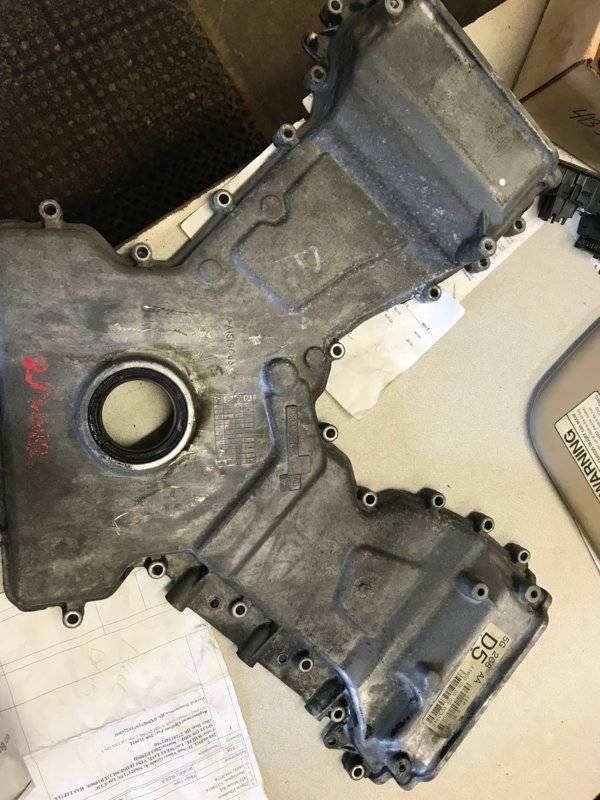

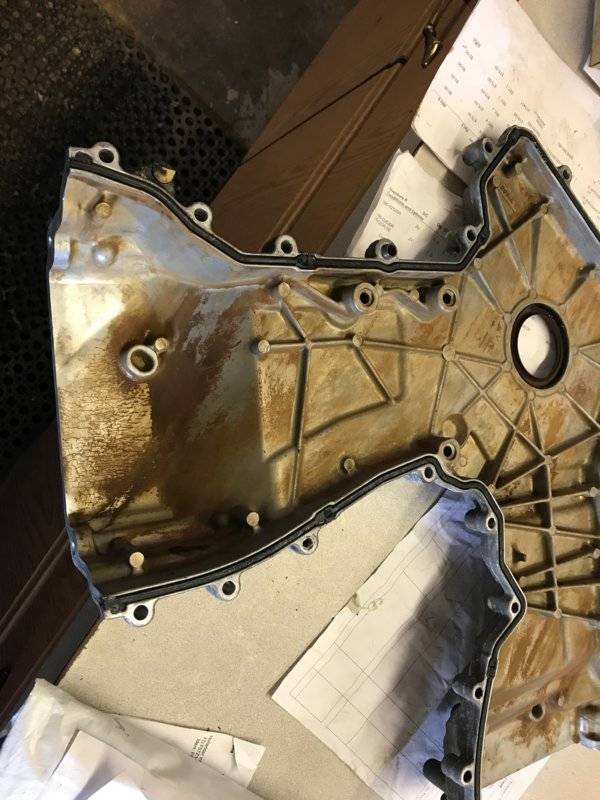

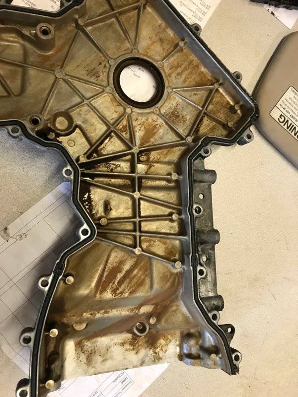

I paid $45 + $16 to ship 2 day from eBay. what do you see? Gasket still attached ?
Well, Expletive, The mechanic just called and told me bad news. It seem that there are two dowels that insert between the Engine front cover and the block. When he removed the cracked one, the dowels stayed in the block holes. He had a bad experience trying to get similar out on a previous job and just left them in. The new part I just got off of Ebay had the dowels still corroded into the cover. In his attempt to remove them he cracked the cover. !! Now, I have to find another cover (may have one available from another member), but wonder how this problem can be solved if the new part has the dowels corroded onto the cover, as well. Will some kind of soak loosen them, I need some options from someone who may be familiar with a problem like this. Thanks. The AC compressor and power steering pump are out and the harmonic balance and seal ready to go back on, except for this PIA.
Try presoaking with some penetrating fluid for 24hrs.
Ping the dowels with a metal hammer ever so lightly (theory of freeing corrosion bond by means of vibration from impact).
Locking pliers on the dowels. Rock back and forth ever so gently.
Bit of heat as last resort. Mind the rubber gasket.
Thanks, RigsLS. The new one is on its way. Im hoping that , in this case, I wont have the dowels to deal with since I did not see them in the pics that were sent. The mech tried the ping and pliers method on the 1st one. The soak and heat didn't dawn on him until after the cracking of the cover, unfortunately. Ill post what happens on #2 try.
